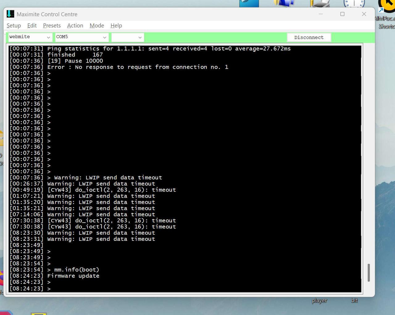

When using a Pico 2W and MMbasic I seem to have a problem with reliability of TCP/IP.
Perfectly willing to accept I am in the wrong, somehow!
Details: Pico 2W genuine. Loaded with MMbasic. ALL versions tried from 5 through to 6 and now into V6.04RC1. Using a simple program to ping a WAN server 8.8.8.8 or 1.1.1.1 or LAN router. Pause 10 seconds and repeat.
Program operates as expected but after a random time, mostly only an hour or a few hours, displays "No response to request for connection 1". (sometimes I have seen a different connection number).
Program ceases at that point, and falls back to the command line >.
Run "ping.bas" or * and the program runs and operates normally again.
In reference to the picture below the Pico appeared to be connected by USB port but no communication was possible. No flashing device led. Had to power off/on to make it work again.
Per the picture where the ping test failed at 00:07 with "Error: No response to request from connection 1"
Then there appeared to be several keyboard returns entered, but no one was awake or at the keyboard at the time! Do I have ghosts? Then there appears to be a CYW43 error timeout.  [CYW43] do_ioctl(2, 263, 16): Timeout.
Then several LWIP timeouts.
LWIP warnings I have seen before on TCPIP failures where no other information appeared. Program just fails back to not running and normal command prompt.

Samples of most common failures.

Posts: 11892
Posted: 01:51pm 22 Sep 2026
You have a TCP SERVER PORT defined but you are not handling requests in your program. At the command prompt the system will automatically send out 404 if it receives a request but in a program it expects you to do it.
If you don't need the server, OPTION TCP SERVER PORT 0 and it will stop.
Or add to your program:
WEB TCP INTERRUPT WebRequest       ' 'b' tell the server who answers
Sub WebRequest                     ' 'c' answer, then close, every request
 Local Integer i
 For i = 1 To MM.Info(MAX CONNECTIONS)
   If MM.Info(TCP REQUEST i) Then
     WEB TCP READ i, buff()
     WEB TRANSMIT CODE i, 404
   End If
 Next i
End Sub
