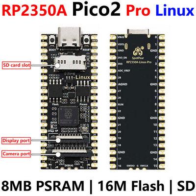

Hi all,
i have just received this nice little RP2350A board from China (alixexpress) called "Spotpear RP2350A-Linux-Pro Board" for 11GBP (so under 15USD).
First impressions are very positive, it has the "normal" Pico formactor but adds a SDCard slot and 8MB PSRAM.
Seems to run fine @384Mhz
> option list
PicoMite MMBasic RP2350A V7.0.00b6
OPTION FLASH SIZE 16777216
OPTION COLOURCODE ON
OPTION CASE UPPER
OPTION PICO OFF
OPTION CPUSPEED (KHz) 384000
OPTION DISPLAY 36, 100
OPTION SDCARD GP21, GP22, GP23, GP20
OPTION COMPILE ON
OPTION PSRAM PIN GP19
> list pins
GP0      1      OFF
GP1      2      OFF
GP2      4      OFF
GP3      5      OFF
GP4      6      OFF
GP5      7      OFF
GP6      9      OFF
GP7      10     OFF
GP8      11     OFF
GP9      12     OFF
GP10     14     OFF
GP11     15     OFF
GP12     16     OFF
GP13     17     OFF
GP14     19     OFF
GP15     20     OFF
GP16     21     OFF
GP17     22     OFF
GP18     24     OFF
GP19     25     Boot Reserved : PSRAM CS
GP20     26     Boot Reserved : SD MISO
GP21     27     Boot Reserved : SD CS
GP22     29     Boot Reserved : SD CLK
GP23     41     Boot Reserved : SD MOSI
GP24     42     OFF
GP25     43     HEARTBEAT
GP26     31     OFF
GP27     32     OFF
GP28     34     OFF
GP29     44     OFF
docs and schematics are here: docs
I have only tested the "basic" version of mmbasic, no hdmi/vga/usb testing done yet.
Will do some more testing but I really like this board so far.

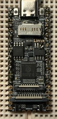

Nice board. Unfortunate choice of pin for PSRAM select though. :(  Perhaps a mod might be possible to change it to GP0.
fred777
Joined: 01/07/2021
Posts: 106
Posted: 12:15pm 10 Oct 2026
Bodge done, PSRAM CS is now on GP0. A bit ugly but I'm happy with it
Will add some glue to keep the bodge wire fixed. And I kept GP12-19 free for a HDMI adapter.
Edited 2026-10-10 22:16 by fred777
Posts: 9181
Posted: 01:19pm 10 Oct 2026
Exactly how I pictured it, but I'd have used yellow wire as I have some and I suspect the electrons like bright colours. :)
Just one point, did you preserve the pullup? If not you may find that you need one.
Edited 2026-10-10 23:21 by Mixtel90
fred777
Joined: 01/07/2021
Posts: 106
Posted: 01:31pm 10 Oct 2026
No, the pin goes straight to GP0, I did the same with this board, and it didn't seem to matter. Perhaps it could fail in a noisy EMC environment.
Edited 2026-10-10 23:32 by fred777
ville56
Joined: 08/06/2022
Location: Austria
Posts: 627
Posted: 04:12pm 10 Oct 2026
  fred777 said  No, the pin goes straight to GP0, I did the same with this board, and it didn't seem to matter. Perhaps it could fail in a noisy EMC environment.
Without pullup it may work sometimes, but it is not reliable. There are phases of operation (e.g. booting up) where the CS pin of the PSRAM is floating. Believe me, I made the same error. Ended up that I couldn't even flash a new firmware anymore. Installed the pullup and all issues were gone.
73 de OE1HGA, Gerald
fred777
Joined: 01/07/2021
Posts: 106
Posted: 05:42pm 10 Oct 2026
Ok ok, another bodge
Don't even start about about how ugly this looks - I'm just glad the thing still works.
Edited 2026-10-11 03:43 by fred777
