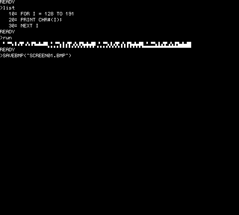

In the mean time, I have made a few minor changes to the firmware.
1) I have implemented Graphics Characters for CHR$(128) to CHR$(191) this give compatability for the TRS-80 / System-80 Basic Character set.
2) I added a few extra alias for some of the existing command. Again to give better compatability with the TRS-80 / System-80, (SET,RESET,POINT)
3) I extended the keyboard scanning to detect and report some of the PS/2 Extended key codes, (i.e. for the Arrorw keys etc)
4) I changed the way the cursor was implemented, so it was possible to display the cursor under a character, and not instead of.

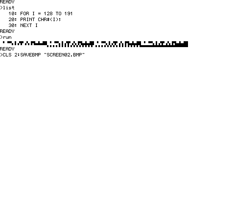

5) I also wanted to be able to flash the screen very quickly, so I extended the CLS command to take an optional argument. 'CLS 1' for fill with White, and 'CLS 2' to invert the screen.
6) I added Bitwise Left and Right Shift operators (1 << 2) ==4 and (4 >> 2) == 1
7) And lastly I could not resist after I saw it listed here, I changed the prompt to match the TRS-80/SYSTEM80
READY
>_
See attached screen shots.
Jimbo.
Now the inverted video.
