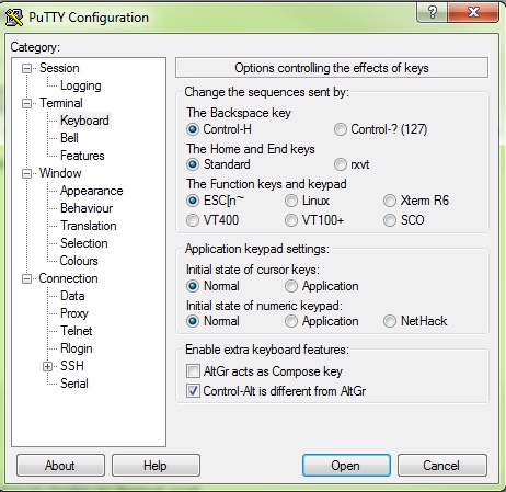

A quick tip when using PuTTY with the Maximite - maybe already known to some:
If you want to enable the backspace key to work "normally", ensure you set it to Control-H under the Keyboard settings (see screenshot).
I hope it helps somebody - it nearly drove me loopy not being able to backspace when accessing my MM via terminal...
