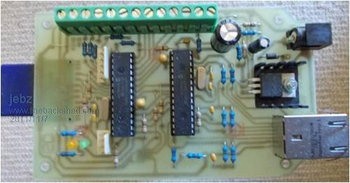

Last year I made some changes to the design of the WIB PCB to incorporate an ICSP connection and add power to the serial connector. These were integrated into the artwork by Bob Barnes of RCS Radio. RCS has this version of the board as 3178C. I also found a cheaper ethernet socket part stocked by Farnell RJMG163217101NR was suitable. Another worthwhile change is to the CPU, a dsPIC33FJ128MC802-I/SP allowing expansion of the code.
