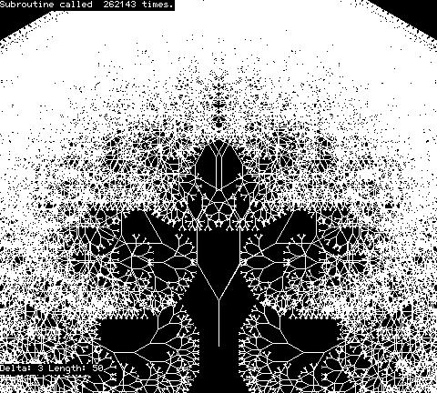

indeed (in regards max nested gosub's)
140 delta = 1
150 length = 250
causes an error
yet
140 delta = 1
150 length = 249
works ok.
I was going to let it go but after some thought I concluded loopcount was going to max out
at 3.40282347e+38 long before it finished, which would be somewhere around 3.232856e+492 !!
I stopped it after about 30mins which had loop count at ~1e+06
Cheers,
Anthony.
Screenshot of another.
Image is Delta 3, Length 50, turtlespeed = 0, 194s to draw.
