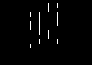

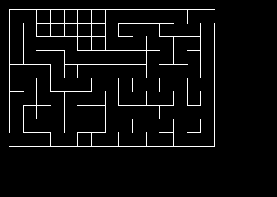

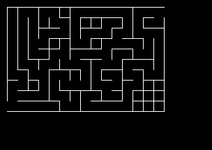

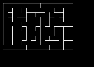

This time i made a little Labyrinth generator , it's not actually perfect because
i get some unsolvable Laby but it can be a base to some who want made a Labyrinth
style game.
Here are some pics:
and here the source:

You can change the Width and Height here:
50 Labwidth = 15
60 Labheight = 10
If someone correct it to made a generator who create 100% solvable Laby
each time , please post the source here.
Cheer.
Posts: 5203
Posted: 03:13am 01 Jan 2012
That works OK Darth, thanks for posting. I do remember a maze generating program from some time ago, I'll keep an eye out for it.
I also remember one maze generating algorithm that took a room, added a wall to split the room into two, and then added a door way between the two rooms. It did this, splitting smaller and smaller rooms, until it reached the minimum room size, same size as the doorway/corridor.
