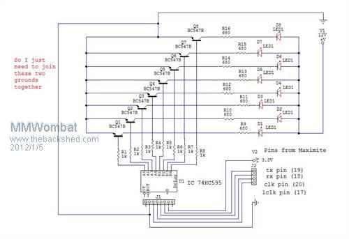

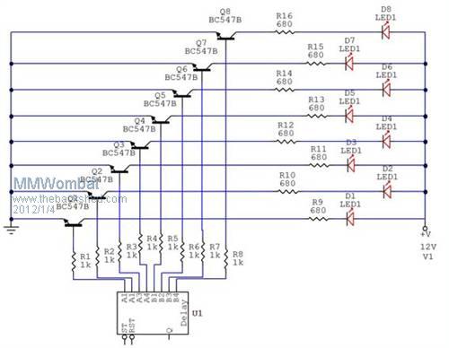

@ Shaz_AU
Essentially, you have it correct, but the command for SPI changed @ V3 I think, and the new format is
received_data = SPI( rx, tx, clk, data_to_send, speed, mode, bits )
bits default to 8 and can be omitted for a single 595 chip. Two chips daisy chained together and you could set bits as 16 (send two bytes) to send both chips the desired output. Bits maximum is 24 I think. My command for SPI_DMD() has this bits set to 32.
I also found the mode may need to be changed to 3 for the 595 chip.. Just try the default of zero. If no output try setting the mode to 3.
ie:
junk = SPI(rxPin, dataPin, clockPin, numberToDisplay, H, 0)
or
junk = SPI(rxPin, dataPin, clockPin, numberToDisplay, H, 3)

- So is there a reason why you set the clock and latch pins high at the start of the program? Would this not display whatever junk is in the shift register at startup?
- Is the pauses you have in the sendData function necessary?

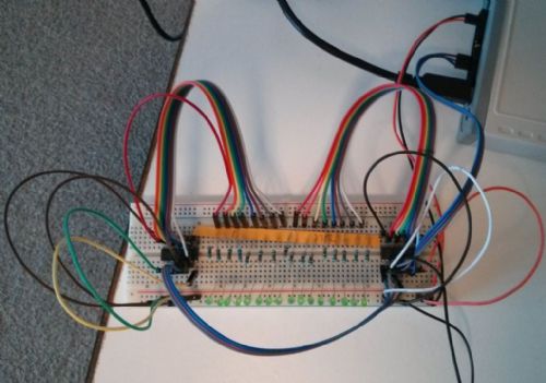

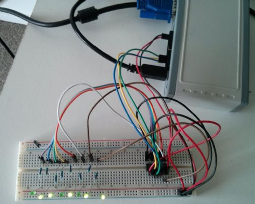

- Expanding on your idea of 2 registers daisy chained together; if I wanted to send data to 4 registers is it just a matter of pulling the latch pin low, dividing up the 32bits into two 16bit spi commands and sending them one after another, then pulling the latch pin high again? I don't actually want to do this, I'm just curious.
My first goal is to use two 74hc595 chips to build a 8x8 switch matrix that along with 8 NPN(TP102), 8 PNP(TP107) transistors and a lot of diodes can control 64 separate lamp outputs.
Now if only the postie would hurry up and do his part so I can get started

@ Shaz_AU
Yes you would do just that.
When I had four 595's connected together, and The command was 8 bits, I would send 4 8 bit commands.
temp1=234
temp2=56
temp3=45
temp4=176
Pin(17) = 0 'assert the enable line (active low)
junk = SPI(18 , 19 , 20 , temp1 , H) 'send the command
junk = SPI(18 , 19 , 20 , temp2 , H) 'send the command
junk = SPI(18 , 19 , 20 , temp3 , H) 'send the command
junk = SPI(18 , 19 , 20 , temp4 , H) 'send the command
Pin(17) = 1 'deselect the slave
but now would be
temp1=234
temp2=56
temp3=45
temp4=176
junk = SPI(18 , 19 , 20 , (temp2*256)+temp1 , H, 0, 16) 'send the command
junk = SPI(18 , 19 , 20 , (temp4*256)+temp3 , H, 0, 16) 'send the command
I suppose I set the pins high, so as there would be a transition from high to low. I don't know if it would make any difference, as it would only be a approx 35 nano seconds per line before my data was sent....
Regards Dennis

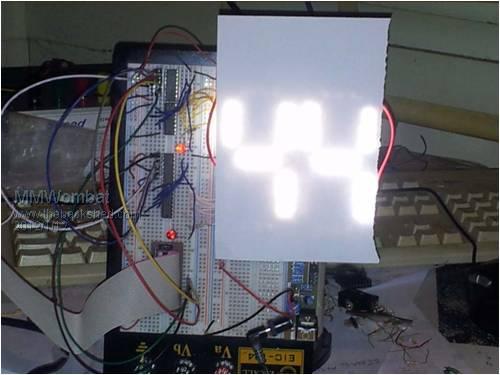

PS. With the DMD panels, you only have to tell the program how many horizontal and vertical panels you have, and then draw everything to the screen, and it will display on the panels automatically.
Maybe I should add it to the library, with a .hex of the Maximite version which holds the SPI_DMD() command added to the source..
Am still working on getting it to work on the CMM though....

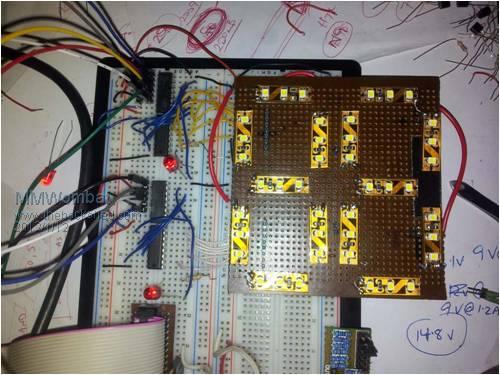

I also experimented with an 'Austria Micro Systems' AS1107 8x8 controllers
This is the thread link
It may be easier than using the 595's
There is also a Maxim chip, 7219, but I think it was discontinued?
Regards Dennis

Shaz_Au
Joined: 31/10/2012
Posts: 11
Posted: 03:54pm 06 May 2013
So the postie delivered some goodies and I got straight into it. Guess what... It actually worked first time! That never happens.
Can you tell I haven't used breadboard before?
Now to add a 2nd shift register and modify my basic code to use those leds too before I play with any matrixing
Thanks for the help Dennis
Cheers,
ShazEdited by Shaz_Au 2013-05-13

V2.0
2 shift registers
16 LEDs
3 light effects (knight rider + additive scroll from left & right)
Here is the breadboard:
Here is the code (some of the repetitive comments could of been removed!):
