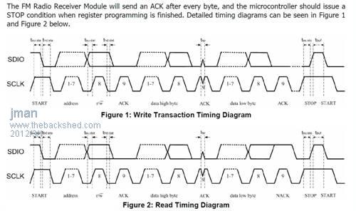

Posted: 07:07am 01 Mar 2012
Hi
I have recieved the I2C radio many thanks to Rob
Now I just cant seem to wrap my head around on how to use the I2C with it.
The I2c address is &H11 with the following Registers that contain 16 bits

The timming is as this pic
So i have the following
Dim RegsH(8)
Dim RegsL(8)
I2caddr = &h11 ' RDA5807 I2C address
I2CEN 100,100 ' Enable I2C
I2CSEND i2caddr, 1, 1, &H0A
I2CRCV i2caddr, 1, 8, RegsH(0)
? "0=ok 1=nack 2=timeout"; MM.I2C
I2CRCV i2caddr, 0, 8, RegsL(0)
For I = 0 To 7
? I; RegsH(I)
Next I
For I = 0 To 7
? I; RegsL(I)
Next I
This produces the following
I would have assumed the results would 0's as this is the default

crackerjack
Joined: 11/07/2011
Posts: 164
Posted: 09:22am 01 Mar 2012
Jman, just had a brief look so I may be way off the mark, but is there not a bit of confusion in your program between bits and bytes? You are reading into a buffer of 8 bytes and then iterating over those bytes in the debug loop. Should you not be reading two bytes High and Low and then dealing with the bits as per the register?
jman
Joined: 12/06/2011
Posts: 711
Posted: 06:08pm 01 Mar 2012
CrackerJack
Thats the problem you are a winner
