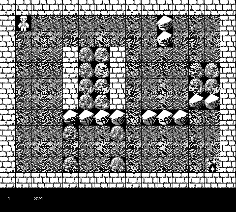

Here is a preview from my next little game
This time , like boulder dash or Rocks & Diamonds games you have to collect
all Diamonds in a level before you can go into the next one.
Actually the output door has no effect , the Hero cant die and go
to the next level when the last diamond is collected.
It's still allot to do for finish but i have want let you all test
it
I get the sprites graphics from this free game : Rocks & Diamonds .
Then converted them to B/W and finally cut all to made the Sprites font.
The control is easy ... the 4 directions keys or the 'Standard' MM joystick.
Here are some pics :

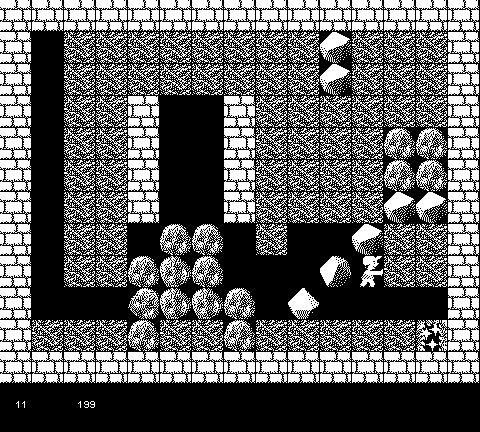

I have improve the game.
Added the monsters , dynamites and some 'beeps'

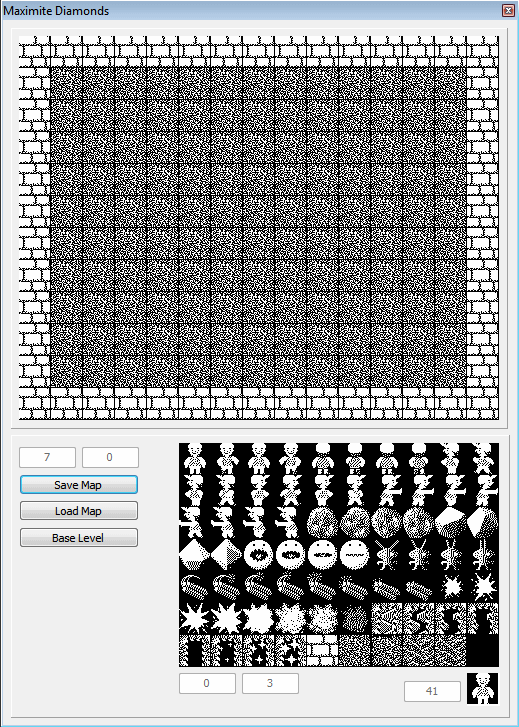

The level editor is finished too 'write in Delphi'
Here is the game :
2012-04-21_050713_diamond.zip
Here is the Level editor :
2012-04-21_050805_MMDiam_Delphi.zip
And here is a little PDF to explain the editor ...
2012-04-21_050846_MMDiam_Level_Editor.pdf

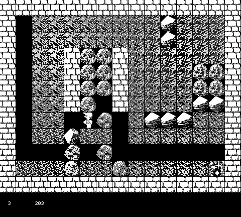

Posted: 02:16am 21 Apr 2012
Another great game. I love it when the dynamite goes off!!
I am still trying to figure out the rules, seems that when you let off the dynamite you can also run away to avoid the blast. Then, you have a pile of more diamonds to harvest.

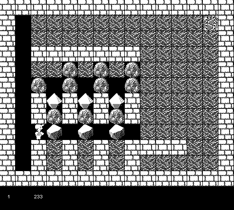

Better to go away when you drop a dynamite or ... you die
The rules are simple , get all diamonds from the level for start the
next level.
The dynamite are just supposed to destroy the walls who block some of
the diamonds

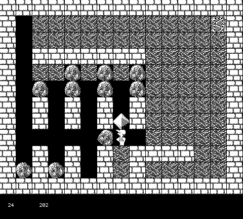

Now to kill a monster , just let a rocks fall on it and run away because
the monster is going to explode.
I don't know if you can optimize the interpreter that the level 4
run faster (the one with only 1 diamond and allot rocks falling down).
Just try to move when the level start and you will see what i mean.
This one was a test level for see if the interpreter was able to manage
full of sprites fast enough.
