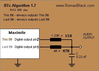

Raros
Joined: 06/02/2012
Location: Italy
Posts: 55
Posted: 09:40pm 13 Mar 2012
Hi
I have tested it myself.
With the audio output does not go: and 'a disaster.

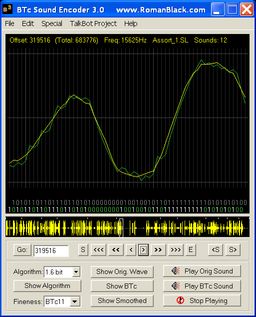

I tried the excellent BTC Sound Encoder 3.0 software
free on site http://www.romanblack.com/picsound.htm
I used 1.7 because the algorithm 'is the best
speed on Maximite.
See BTC Sound Compression Algorithm http://www.romanblack.com/btc_alg.htm
I used two resistors and a capacitor to pins 1 and 2 of Maximite. Something feels ....
I could put a LM358 to increase the volume.
Examples:
10 ' Playback sound with BTC encoder 1.7 - PIU' VELOCE
12 ' New Bit Pin -> resistor value 1.33R -> is always output = 15k
14 ' Last Bit Pin -> resistor value 4R -> is always output = 47k
20 Cls
50 x=949:' num data
100 Dim a(x)
110 For t = 0 To x
120 Read a(t)
180 Next
185 pa=0.02
200 Setpin 1,8:Setpin 2,8: ' Pin 1=Last Bit : Pin 2=New Bit
300 for t = 0 to x
310 P128 = a(t) And 128:Pin(2) = P128:Pin(1) = P1
315 Pause pa
320 P64 = a(t) And 64:Pin(2) = P64:Pin(1) = P128
325 Pause pa
330 P32 = a(t) And 32:Pin(2) = P32:Pin(1) = P64
335 Pause pa
340 P16 = a(t) And 16:Pin(2) = P16:Pin(1) = P32
345 Pause pa
350 P8 = a(t) And 8:Pin(2) = P8:Pin(1) = P16
355 Pause pa
360 P4 = a(t) And 4:Pin(2) = P4:Pin(1) = P8
365 Pause pa
370 P2 = a(t) And 2:Pin(2) = P2:Pin(1) = P4
375 Pause pa
380 P1 = a(t) And 1:Pin(2) = P1:Pin(1) = P2
385 Pause pa
500 Next
510 '
515 '
520 '
600 End
900 ' data
1000 DATA 220,075,084,091,221,128,031
1001 DATA ........
1002
Here are some examples:
Rockmon17-16_8000.bas
Blackfire17-16-8000.bas
Blackfire17-21-6000.bas
Maximite3-17-16.bas
2012-03-14_073247_PlaySound.zip
Come on Geoff I can not wait.
If you can put even the VOLUME control:
Do you remember the SAM Software Automatic Mouth?
I'm working, I would like to convert MMBasic.
In 80 years I have converted the C64 version for the VIC20 expanded with all the memory banks. It still works with WinVice!!!!!
Raros.
