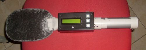

I'm (slowly) working on a 125KHz animal tag reader project using the Mini Maximite as the controller and the reader is a slave module made by Priority One here in Melbourne (Model RFIDRW-E-232 - Atmel Mega 168PA based). Communication uses RS232.
I'd be interested in your cattle reader project as a more embedded option than the RFIDRW-E-232 module. Where can I find information on the project?

  paceman said   Where can I find information on the project?
I originally did it on the Ozelectronic forum but I'm happy to do it here again stage by stage if you like. I had always intended to Atmel it (currently runs picf88 as master/number cruncher) as well I would like to "blue tooth" it so no download cable is needed - currently dumps into a usb-serial cable.
The prototype is a bit rough - works on 6 to 8 half flat AA cells with a read range of about 180 to 200mm. Good enough for yard work - works in a pen of cattle if you fit unit to a bamboo pole or the like and scan over the animal's heads. Unit will not record duplicate tags, and will hold up to 600+ tags with group separators (blank tag) for multiple herds.

My need is pretty simple - your cattle reader is doing a lot! I'm reading a passive FDX-B implanted cat tag with a very short read range - like 20mm or so, at the entrance to a cat door! The RFIDRW-E-232 module continuously scans for a tag and transmits the reading as ASCII text when it finds one. It's a nice module, 35X65mm and $40 or so, and can accept about a dozen plain text commands but it's overkill for what I need. The Mini-Maximite controller will be quite close to the reader (about 300mm or so) and has to have other power/control wire circuitry, so serial via wire is easiest for me.
I'll check out your Ozelectronics project. At this stage I'm pretty well set up with what I have and the programming is underway in MMBasic but it would be nice to be able to put a few components on the Main board rather than piggy-back the module.
