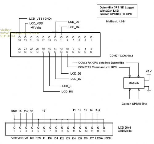

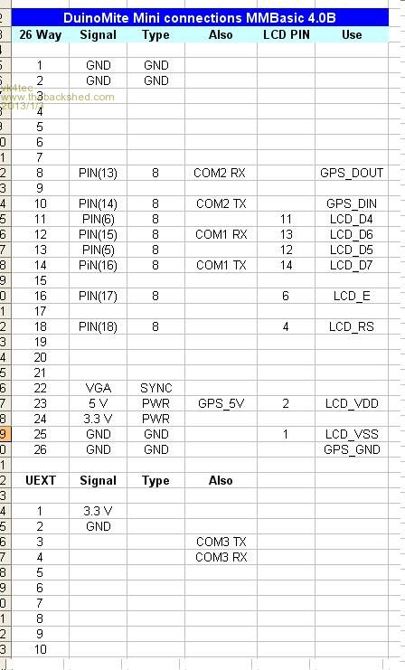

Hello
I am re-visting an LCD/GPS setup.
My DuinoMite logger currently uses COM1 under MMBasic 4.0B
I have a clash, and I need to move to COM2
COM3 is still on the UEXT connector.
Geoff, et all, can you confirm please that COM2 is PIN(19)IN and PIN(20)OUT
Anyone had better results with ribbon cable ?
I have the grey stuff and its pretty fragile. ( wire is pretty thin )
I got the CRO out and found these :
- Andrew -
Edited by vk4tec 2013-01-04
Andrew Rich VK4TEC
www.tech-software.net

Here is a graphic of my connections
- Andrew -
