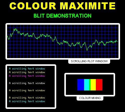

Knocked this up on a rainy Saturday afternoon...
Just a demonstration of some of the possible uses for the BLIT command, especially in the use of scrolling data display windows.
Download the ZIP file here and unpack the 2 files in the same directory.
RUN"BLITDEMO" to start.

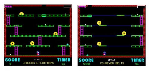

Don't forget to check out my new game "Donut Dilemma" here at my website.

Nick,
Just tried out your BLITDEMO. That's pretty impressive, I never would have thought of using the BLIT command those ways.
Haven't mastered Level 1 of DONUT yet - think I must have been born a little bit early, I'm spending a lot of time landing on my head!

Blit is a powerful command for screen manipulation. That's why I created this demo to try show it off a bit.
Still stuck on Level 1 of Donut Dilemma? Hmmm, I tried to adjust the difficulty level to be balanced. I know joystick control makes a big difference to the ease of use.
I can actually do all 10 levels in one game so I was worried the game was too easy. My kids play keyboard control (they're use to it on their PC) and they seem to go a fair way.

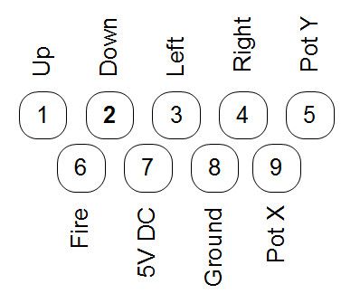

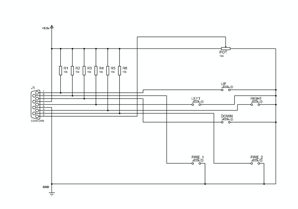

I documented (in upcoming Beginning Maximite document) the joystick connections as follows:
Software pin Joystick signal J1 on CGMMSTICK J9 on CGCOLORMAX
Pin(11) Up 21 4
Pin(12) Down 22 6
Pin(13) Left 23 8
Pin(14) Right 24 10
Pin(15) Fire Button 25 12
Pin(10) Pot Y 20 3
Pin(9) Pot X 19 5

Yes. This good. It supports analogue X/Y pots and digital switched inputs.
I have an idea for a simple and low cost joystick interface. The idea is to have a really small PCB soldered directly to the pins of the IDC (?) maximite connector. A 9 pin D type connector will also attach directly to the PCB by wedging the PCB between the D connector pins.
The whole thing is very small. Just need someone to make up a professional PCB.

I could do that.

Getting a bit off topic from the BLIT command but could the joystick port be specified with respect to say the PC pinout, using a 15 pin D-SUB instead of a 9 pin. Allows for 2 joysticks (4 analog channels) and 4 buttons, good for 2 player games. All pinouts.org has a nice write up. 5 volt pins would be 3.3 volts instead.

That is a great demo Nick. You especially show what can be done by BBLITing selected colours. It took me some time to figure out why the gridlines of the scrolling graph did not move but that was the secret.
It would be good if Hugh could add the demo to the MMBasic Library.
BTW I am still at level 3 of Donut but I am making progress!!
