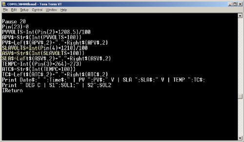

  plasma said   hi ,
how to cut the last digits from a number ?
a= 1.550001
but i need a = 1.55
anyone ? thx

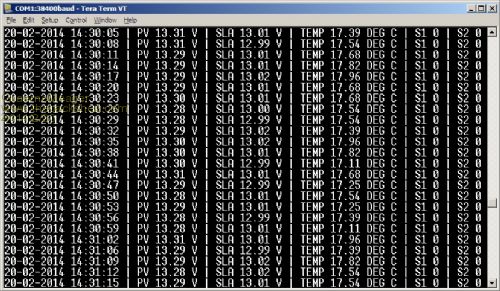

Plasma, had the same frustration when trying to display info on tera term with the micromite.
So I formatted them by multiplying by 100, taking the integer and rebuilding a string with the decimal point.
This is the result:
Posts: 10099
Posted: 08:30pm 19 Feb 2014
The image with the code is hard to read - probably not your fault - the forums automatically compresses photo data....
Can you please repost it in a code box?
Just makes it easier to read without straining my little eyeballs too much.
OA47
Joined: 11/04/2012
Posts: 1064
Posted: 09:04pm 19 Feb 2014
Sorry about that Grogster. Here's the code in a code box.
PrintToScreen:
PVVOLTS=Int(Pin(2)*1208.5)/100
APV$=Str$(Int(PVVOLTS*100))
PV$=Left$(APV$,2)+"."+Right$(APV$,2)
SLAVOLTS=Int(Pin(4)*1210)/100
ASV$=Str$(Int(SLAVOLTS*100))
SLA$=Left$(ASV$,2)+"."+Right$(ASV$,2)
TEMPC=Pin(3)*264-273
ATC$=Str$(Int(TEMPC*100))
TC$=Left$(ATC$,2)+"."+Right$(ATC$,2)
Print Date$;" ";Time$;" | PV ";PV$;" V | SLA ";SLA$;" V | TEMP ";TC$;
Print " DEG C | S1";SOL1;" | S2";SOL2
Return
