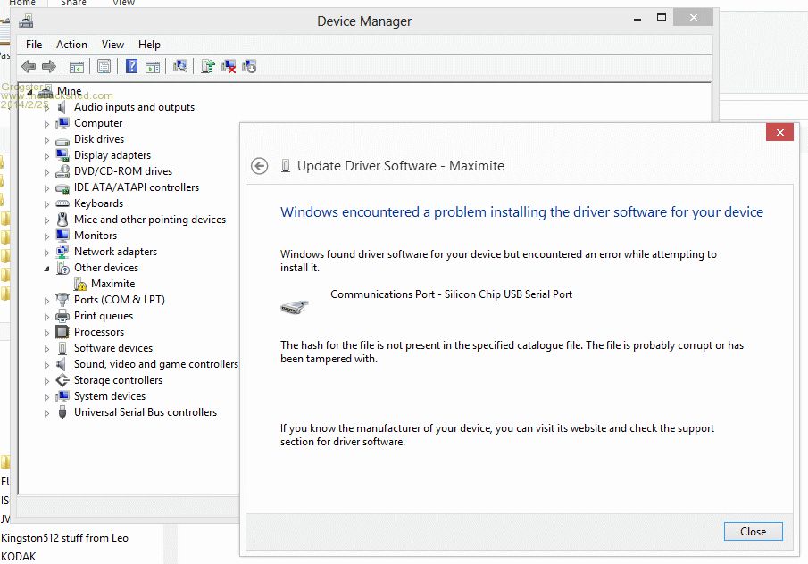

As per title.
I have redownloaded the ZIP file from Geoff's site, but all I get is this message:
Did not have this issue in Win8-32-bit, so dunno what is going on.
Anyone got any hints?
mchpcdc.inf is 3371 bytes
mchpcdc.cat is 7259 bytes
EDIT: Did a full reboot in case Bill(Gates) was doing something funny, but still no go. The system is fully up to date, according to Windows Update.Edited by Grogster 2014-02-26

I had the same problem with my new 64bit laptop, you can boot windows into a mode that allows you to use unsigned drivers, I think you press F8 as windows starts.
Something in the driver has been changed so it works with Maximite.
Alan
Posts: 3372
Posted: 03:35am 25 Feb 2014
If you are using Windows 8 you must instructed it to install "uncertified" drivers. The procedure is documented in this thread on the Back Shed forum: http://www.thebackshed.com/forum/forum_posts.asp?TID=5313&PN =1

  Quote  After pc restarts click on trouble shoot
Then click on advanced options
Click on startup settings
Click on restart
Wait for PC to start up again
Select disabled driver signature enforcement by pressing 7
Once PC boots up you will now be able to go in and update silicon chip driver
After it installs correctly restart the PC to return to normal driver signature enforcement mode.
Looked in that thread, but after the first reboot, there is no trouble shooting option, icon, or app on the start screen. There is no Trouble Shooting option in CHANGE PC SETTINGS. There IS Troubleshooting in Control Panel, but no Advanced options for me to play with.
Little prod?
Funny how I had no problems at all in Win8 32-bit, it was only once I rebuilt the machine using 64-bit, that this problem has surfaced. Edited by Grogster 2014-02-26

I didn't have any problems with W8 64 bit.
This link might shed some more light on it.
http://www.howtogeek.com/167723/how-to-disable-driver-signat ure-verification-on-64-bit-windows-8.1-so-that-you-can-insta ll-unsigned-drivers/
There are two unwanted spaces in the link in 'signature' and 'install'.
Depending on how you have your PC configured, there will be a few differences but the instructions are reasonably clear for such a convoluted procedure.
Posts: 10100
Posted: 01:13pm 25 Feb 2014
Excellent - thanks Jim!
All going.
Crikey - that's a few hoops to jump through, but I suppose so long as you can disable it, having signed device drivers is not really that bad an idea, IMHO.
My mistake was that I was going to the desktop before trying anything on that list - not sure why my brain was telling my mouse finger to do that, but.....
