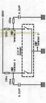

I debounced it this way:
If you don't rotate to fast it is ok.

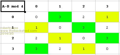

and what does MMbasic produce as the result of "(-1) MOD 4"? the result of MOD on negative numbers should be as follows:
(-1) mod 4 = 3
(-3) mod 4 = 1

btw, the logic i used was based upon the following map:
green and yellow represent the two different directions of rotation, while white cells are the 'illegal' states where a transition has been skipped.
