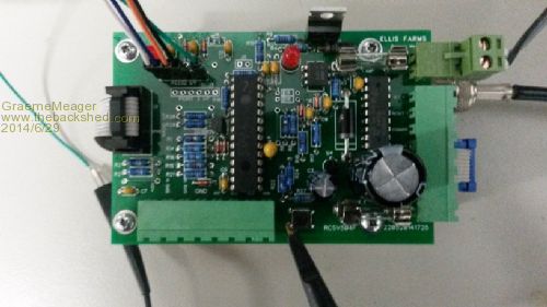

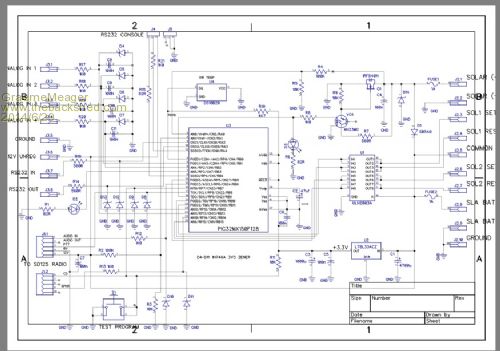

Posts: 10100
Posted: 08:29pm 28 Jun 2014
What would be the chances of you uploading a photo of how things are connected up?
That, or a schematic diagram - just freehand pen and paper would do...
This thread is intensely interesting to me, although I have no bright ideas to contribute at this point....

OA47
Joined: 11/04/2012
Posts: 1064
Posted: 10:02pm 28 Jun 2014
@Grogster:
The schematic is close to being accurate, I have made a few modifications over the past few days.
Posts: 10100
Posted: 10:32pm 28 Jun 2014
Thanks, Graeme.
Could you please put the photo and the schematic into a ZIP and post that?
Not your fault - forums have re-sized the schematic so much so, it is unintelligible.
EDIT: Your PCB looks fantastic, I must say....Edited by Grogster 2014-06-30
OA47
Joined: 11/04/2012
Posts: 1064
Posted: 11:32pm 28 Jun 2014
@Grogster I'll try again:
2014-06-29_092718_RCS_REMOTE_SCHEMATIC.zip
2014-06-29_092923_pcb_2.zip
PS Grogster this project is a love job I have taken on for my brother-in-law on his farm. An upgrade to a system I installed many years ago, it is times like this I wish I hadn't said yes.
Posts: 10100
Posted: 11:42pm 28 Jun 2014
Yes, very nice PCB indeed.
At first glance(and I have not had an in-depth look at it yet), I don't see anything obviously wrong electronically, based on your schematic. I will keep a close eye on this thread, and see what others come up with.
As to the wishing you had never said yes, well - most of us here have ALL had that at some point, but it really is time for drinkies(alcoholic or not, depending on your stance) once you finally crack what the problem is, so do hang in there, as we all do want to find out what the issue is - if that is not being to presumptuous of me with respect to the other members of the forum!!!
I am GUESSING that you tested this out on a breadboard BEFORE you got the PCB done, so can therefore be reasonably sure that it should have worked?
EDIT: Looking at the schematic - do you really need 1000uF on the 3v3 rail? Seems like rather a-lot to me... If the radio works on 3v3, then the cap should be on the radio-side of the PSU, not on the MCU side of the PUS. My 2c only.... Also, 4700uF on the input to the regulator? OK if the MCU was to be sucking a couple of amps, but it won't be.Edited by Grogster 2014-06-30

Posts: 6637
Posted: 09:58pm 29 Jun 2014
  Graeme Meager said   BTW I did fire up one of the original boards using FIN on pin 15 instead of AIN on pin 25 and the software does not re-boot.
More guessing.
Could you try removing R13 (the 1k resistor in the speaker line) or short out D11.
This effectively removes the audio without changing anything else.
If the micromite no longer resets, I expect that you are overloading the analogue inputs.
The 1N746A has a fairly large forward voltage drop (but I couldn't find a low current figure) and that might be upsetting things when the input goes negative. A resistor after the diode, between the diode and pin 25 should be enough to fix that problem. Without a resistor, the diode is in parallel with the internal protection and the internal is probably doing all the work.
A Schottky diode in parallel with the zener might also work.
You appear to have good protection in your circuit and there looks like a 0.1uF cap close to the analogue supply pins. The analogue ground is important and a re-arrangement of the ground traces might be needed. This is getting into an area which seems like black magic and not my best area. I usually put in lots of isolation transformers and relays or opto-isolators for the PTT.

OA47
Joined: 11/04/2012
Posts: 1064
Posted: 12:29am 30 Jun 2014
Have done a lot more experimentation and I am convinced that there is a spike at the start of the audio train that I cant pick up on the CRO but this is going over the limits of the analog input which is resetting the Micromite. The 5V tolerant inputs can cope with it ok. I have attenuated the signal by 75% and the software is stable but know I have to put up with RC components that are making the task of identifying the highs and lows difficult. I will have to play around with the component values to achieve the attenuation and try to keep the squareness of the resultant waveform.
Thank you for everyone's contributions

aargee
Joined: 21/08/2008
Posts: 255
Posted: 07:25pm 01 Jul 2014
If you suspect too much voltage on the audio line, try putting two 1N4148 diodes back to back (one A to signal, K to earth and the other K to signal and A to earth) across the line to earth. This effectively limits the voltage to 0.7V, any AC above that and the diode will conduct.
