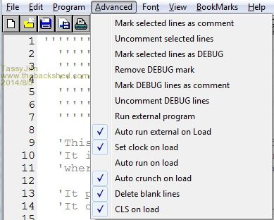

I have been doing more work to make MMEdit more useful with large programs.
If you are not worried about fitting your program into the maximite/micromite memory, you can ignore these options.
I have put them into an 'Advanced menu'
Some of the options were previously in the 'program' menu and some are also in the preferences window. There are grouped here to speed things up for the enduser.
Mark selected lines as comment.
A quick way to comment out a section of code.
Uncomment selected lines. A quick way to reverse the above action.
Mark selected lines as DEBUG. If you have code that is only needed for debugging, it can be marked so that it can easily be converted into comments when debugging has finished, but still be there 'just in case'.
Remove DEBUG mark. A quick way to reverse the above action.
Mark DEBUG lines as comment. Global action to change all DEBUG lines into comments. Usually just before final release.
Uncomment DEBUG lines. Global action when there is still a bug after all!
Run external program. Runs a program of your choice. Your code is saved as a temp.bas file and the program is called with the full path to the temp.bas file as a command line parameter. Holding SHIFT will allow you to select the program. When the program exits, your basic program is reloaded. This allows you to use a pre-processor or syntax checker of your choice. By using a batch file, you can run a DOS MMBasic program with your new program made available for acting on.
Autorun external on load. Runs the above external program every time load and run is selected. In this case your program in the edit window is NOT updated.
Set clock on load. The maximite clock is set to PC time every time you 'load and run'
Auto run on load. The maximite is sent the 'run' command after loading the program.
Auto crunch on load. Comments are removed from your program before loading.
Delete blank lines. Blank lines are removed from your program before loading.
CLS on load. The terminal is cleared after loading the program.

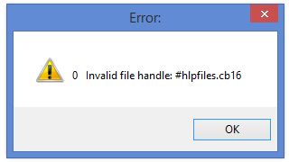

I played with some advanced settings and I get this error when I click on `CLS on Load'
Posts: 6637
Posted: 09:55pm 04 Aug 2014
Bugger...
It was a missing 'x' from a procedure name.
The fix has been uploaded to my website and the attached ZIP has the corrected TKN file
Thanks Mick, it was good to catch the bug before too many had upgraded.

Posts: 2984
Posted: 11:16pm 04 Aug 2014
Thanks Jim,
That works.
