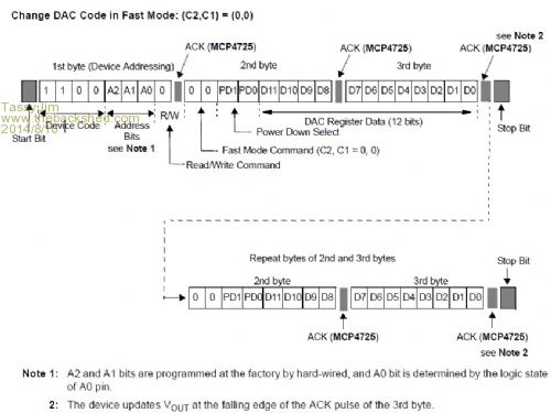

I am trying to get some test code working for the DAC chip on the LCD 44 pinner board but being an I2C dummy, can't seem to get the I2C commands setup correctly..!
All I need is a subroutine to pass the DAC value to (0-4096) and adjust the output pin to the new value..
I am not understanding how to properly send the device address and the rest of the DAC register bits.
Any help with this would be awesome..!! (not much hair left)

I have not done that much with I2C either, but I would expect that:
1) Open the I2C port with the command I2C OPEN 100,100
2) Send bytes to the slave device with the command I2C WRITE addr,opt,data,data,data...
'addr' is the slave address, which is normally specified in this command as a hex byte, but I am pretty sure you can also use binary such as &B1010101 kind of thing - I seem to remember testing that out a while back.
'option' is normally 1, if this is the master on the bus.
Plenty of people use the I2C, so it can't be that difficult.
MOBI is our resident I2C expert, and he has helped me with learning the basics of I2C, so perhaps he will chime in here among others...
EDIT: ASSUMING that the DAC slave address was decimal 10, then you could send data to the device with: I2C WRITE &H0A,1,4096,4096,4096 - that would send three bytes of value 4096 to the I2C device at address 10 - 0A hex.

Yep... I think you got it... I was using the 0 option with the command thinking that it was OK to send the stop condition after the command packet... I changed it to a 1 and I think it's doing something... The DAC went to 0 volts... Hummm.. Ok, more playtime needed...
I am still a bit confused about the proper location of all the bit positions...

I think this seems to be working...
Sub dac_update
DAC_HB=DAC_VAL \ 256
DAC_LB=DAC_VAL And &B000011111111
I2C open 100,100
I2C write &H60, 1, 2, DAC_HB, DAC_LB
I2C close
End Sub
wow.. like you said, not that hard...

'*** I2C MCP4725 ***
MCP4725_addr = &B1100010 ' MCP4725 address with A0 = 0, A1 = 1 A2 = 0
' A0 is set by the enduser, A1 and A2 are factory set
I2C open 100, 1000 ' Enable I2C
do
for n = 0 to 4095 step 10
hibyte=n \ 256
lobyte=n mod 256
print hibyte, lobyte
I2C write MCP4725_addr, 0, 2, hibyte,lobyte
Pause 5000
next n
loop
A VERY slow ramp with the 5000mS delay.
The data sheet is typically confusing.
The 'fast mode' is the simplest to start with and PD1/PD0 can stay at zero. That should keep most of us happy.
You do need to know how the address bits were set in the factory. In my case A1 is set and A2 is zero.
Trial and error will sort it out if needed.
@Grogster,
We are sending bytes with I2C so 255 is the maximum you can send.

I re-tried using the I2C option set to 0 again, and it seems to still be working ok... Not sure why it wasn't before... Anyway, the DAC chip comes with the EEprom DAC value set to mid-scale. I want to update the stored start-up value to 0, so I need to figure out that one next... Also, if I want to read back the DAC value, then is it correct to use address &H61 instead of &H60 as the last bit controls the read/write function of the IC..?

  Zonker said   Humm...
Thanks for the feedback Gent's..!
MMBasic does all the read/write bit setting. Just keep the address at &H60
In your case, &H60 is the upper 7 bits.
Some datasheets confuse the issue by giving the full 8bit value, in which case you would need to divide by two.
If the address given in the datasheet is greater than 7F, you need to divide by two, otherwise leave it as is.

Added to the DAC code by adding the EEprom store command... Just did some bit shifting and add a control byte to the mix... Will try the DAC read next...
Dim dac_buf(5)
Sub dac_store
If DAC_VAL >= 4096 Then DAC_VAL = 4095
DAC_VAL=DAC_VAL * 16
DAC_LB=DAC_VAL Mod 256
I2C open 400,100
I2C write &H60, 0, 3,&H60, DAC_HB, DAC_LB
I2C close
End Sub
Sub dac_update
I2C open 400,100
I2C write &H60, 0, 2, DAC_HB, DAC_LB
I2C close
End Sub
Sub dac_read
I2C open 400,100
I2C read &H60, 0, 5, dac_buf(0)
I2C close
DAC_STAT=dac_buf(0): DAC_HB=dac_buf(1): DAC_LB=dac_buf(2)/16
DAC_VAL=DAC_HB*16+DAC_LB
End Sub
