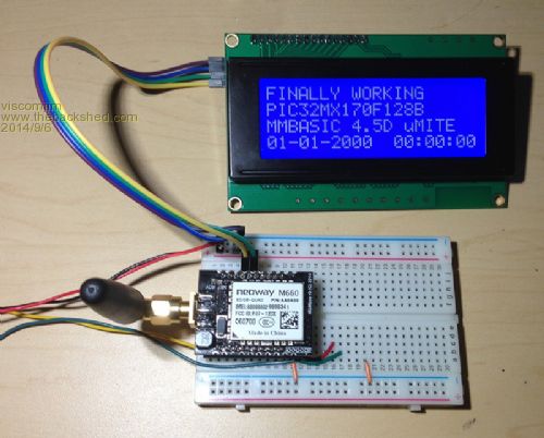

Loaded MMBasic 4.5D for 28 pin 170 and ALL IS WELL!!! Not sure what in the world was going on earlier with this. Now that I can work with the uMite on this board, its time to get the gsm working. This is a pretty amazing board the size of an xbee with a pic32 170 on it. Here is a pic of the board with antenna and an i2c 20x4 LCD hooked up to it. Very small unit...

viscomjim
Joined: 08/01/2014
Posts: 925
Posted: 02:24pm 06 Sep 2014
The board is the one described in this thread
It is a cellular modem which you can see on the top of the board and the pic32 is on the bottom in the small qfn package. I purchased this board from Kon at Dimitech and I believe I paid $40.00.
The board was well thought out as far as the xbee footprint having the weird pin spacing, Kon put .1 pin spacing on the two sides of the board so it could plug into a breadboard. Unfortunately, I did not ask for that and mine came in with xbee pins installed. I purchased an xbee breakout board from parallax and used that to plug into my breadboard.
