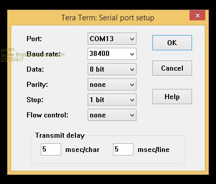

Hi All
I am one those users that uses the built in editor most of the time.
But I now have a really annoying issue that is driving me insane.
While using the editor via TeraTerm if I scroll up, down, left, right,
page up or page down keys quickly over a few lines I get kicked out to what looks like the normal prompt but when I press enter I get an error as per the pic below
The up arrow seems to produce "[A" while the down arrow produces "[B"
sometimes I get the Save Y/N prompt in the editor pressing ESC makes it goway
Anybody got any ideas setting in TeraTerm somewhere ?
I have tried different serial ports with the same result
Jman

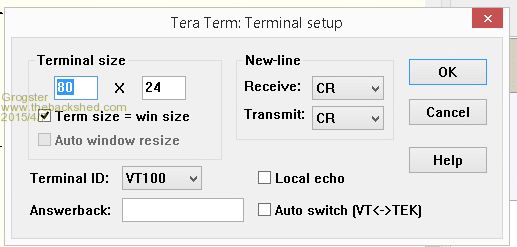

Posts: 10062
Posted: 10:55pm 06 Apr 2015
Hi jman.
Is TT set to VT100 mode?
SETUP menu, then Terminal...
jman
Joined: 12/06/2011
Posts: 711
Posted: 10:59pm 06 Apr 2015
Hi
Yip settings are as below
Jman

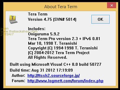

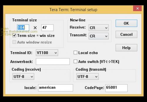

Posts: 10062
Posted: 11:06pm 06 Apr 2015
I don't have the coding boxes on my TT - what version are you using?
jman
Joined: 12/06/2011
Posts: 711
Posted: 11:30pm 06 Apr 2015
Jman

Posted: 11:37pm 06 Apr 2015
jman,
MMB 4.5 manual states tx delay of 50mS - that might help.
Also, don't quite understand the screen dimensions show? Again, from the manual, use 80 x 36 (assuming MM, miniMM or CMM).
Cheers,
Doug.
BobD
Joined: 07/12/2011
Posts: 935
Posted: 11:42pm 06 Apr 2015
I have v4.82 and it shows the same setup page as Jman. The latest is V4.86 from SEP 14.

jman
Joined: 12/06/2011
Posts: 711
Posted: 11:56pm 06 Apr 2015
  panky said   jman,
Cheers,
Doug.
Well Bugger me
I set to 50mS and it is really BAD now set it to 2mS and it seems all good :)
Thanks for the help
Jman
EDIT: Still not perfect but better @ 2msEdited by jman 2015-04-08
