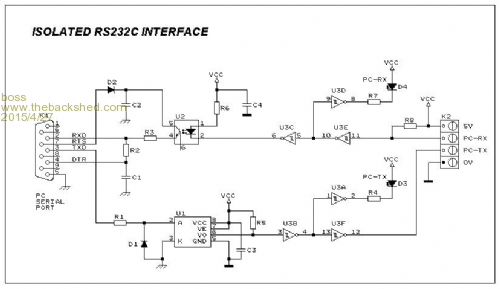

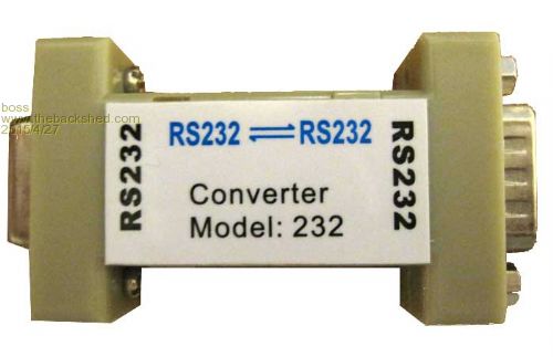

In the old good days before RS485 was born we were used optically an isolated RS232 up to 3000ft @9600Bd (19200 at 1000ft).
