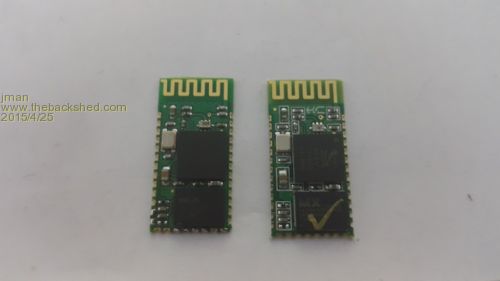

It also seems to be pot luck as what type you receive
I have found 3 different versions all based on the same hardware
HC-05 the preferred option
HC-06 limited to slave mode only
BT04 Different AT command structure so incompatible with HC-05 software
See the pic below the one on left is the BT04 (they look exactly the same)

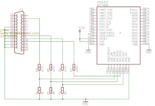

After some Google Fu I found a blog about flashing the modules with
an SPI interface adapter. Link below
Byrons Blog
The Requirements are (I used a Windows XP laptop)
LPT port SPI programmer as per the schematic below
A copy of Bluesuite 2.4 (CSR SDK) this can be downloaded for free at
CSR (Free registration required)
HC05 firmware from here HC05 firmware
Once the software is installed copy the contents for the HC05.Zip to the BlueSuite 2.4 folder and run the following from the command prompt while in the BlueSuite 2.4 directory
BlueFlashCmd -DUMP oldfirmware (This saves the current firmware to oldfirmware.xpv)
pscli query data.psr data.psq (This saves the modules oscillator calibration)
BlueFlashCmd HC05 (Update to HC05 firmware)
pscli merge data.psr (Restore calibration data)
Done now your module is a HC05

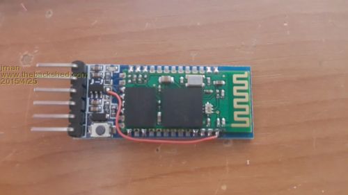

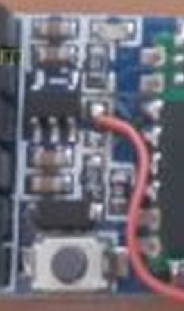

To make it easier to handle carrier PCB's are been used these provide an easy way to power and connect the modules to your device. One short fall is that the EN pin of the carrier PCB is used to enable the power supply and does not put the module into command mode this is done with a push button on the carrier PCB. To solve this you need to remove a SMD resistor and add a wire link as per the picture below. This now allows the command mode to selected via software and a I/O pin.
Jman

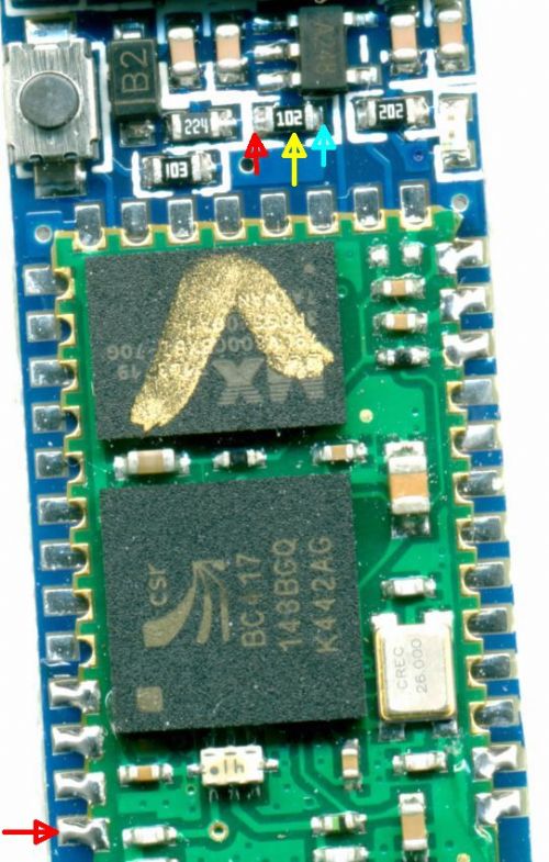

Jman
See the image. Can you be more precise about the resistor to be removed and the location of the wire. I think you are talking about the resistor at the yellow arrow. Where to attach the wire?
Bob
Posts: 10061
Posted: 01:39am 14 Jun 2015
Looks to me like in jman's original image, the wire link is soldered to the point marked by the cyan arrow in your image above. I also agree that he is meaning the resistor at the yellow arrow point.

Posted: 01:53am 14 Jun 2015
Grogs
I had an inspiration. I copied the image from the forum. Expanded it to full size of a 24" screen and then snipped a copy and you are correct. See the fuzzy image.
Bob
jman
Joined: 12/06/2011
Posts: 711
Posted: 09:45am 14 Jun 2015
  BobD said   Jman
Bob
Correct resistor
Yellow wire goes the resistor pad furthest from the button cyan arrow
Attached a better pic
