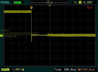

Posted: 12:25pm 16 May 2015
Hi
If I use the above circuit from the manual and use the internal pullup
Every pin EXCEPT pin 25 works. The issue remains ONLY on pin 25
So why would the debounce cap only effect pin 25
The other odd thing I tried the other way ie cap to vcc and pulldown
and it works with no resets (Now I am going grey ah wait a minute I am grey already)
This a look at the waveform when pressing the button all the pins display
pretty much the same if not identical

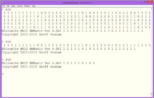

Hi Jman, All,
Firstly John, my apologies for not doing the test the other day when I promised I would try to duplicate your setup as closely as I could..
Secondly, I have finally `extracted my digit' and duplicated as you suggested.
Cap mounted close to the PIC, Resistor mounted on the switch and 3 wires about 6" (150mm) long to the switch.
Thirdly I can confirm the reset issue but it is nowhere as bad as you are experiencing.. See the below screen capture
That is running this code
SetPin 25,din
mik:
Print Pin(25);
Pause 250
GoTo mik
The first Reset occurred after approximately 59secs (each line is 10seconds long).
That was about 1second between presses.. the next couple of times I went madly and random speeds pressing the button and it occurred after 18 and then 8 seconds.
So ultimately it is CONFIRMED ... but I cannot get the 95% resets you are experiencing.. mine is more like 5% resets but still that could be enough to upset your program if it was released into the wild.
