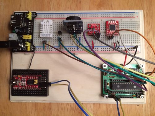

This post describes a Micromite-based data logger. The project uses Big Mick's MuP Micromite board, a DHT22 for measuring humidity, a DS18B20 for temperature, and a Sparkfun BMP180 breakout board for logging atmospheric pressure.
The data is logged on a Sparkfun OpenLog device equipped with a 16GB micro flash card. The setup includes a RTC and all devices are powered using 3.3 volts.
The following is the source code for this data logger. The code for the BMP180 pressure sensor uses part of the code posted by TassyJim in a different thread. The data is saved approximately every minute in a comma-separated-variable (CSV) data file which includes the calendar date and local civil time for each measurement. Temperature is logged in degrees F and atmospheric pressure in inches of mercury.

The following is a picture of the data logger. The 3.3 volt power supply, sensors and OpenLog are located on the large breadboard. From left to right; the DHT22, the DS18B0, the RTC, the BMP180 and the OpenLog device.
A USB-to-TTL interface is located on the bottom left and Big Mick's MuP board is on the bottom right.

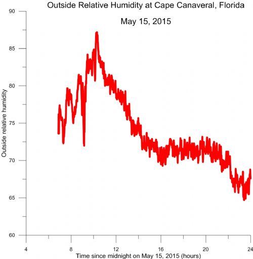

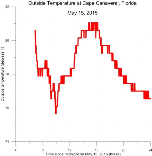

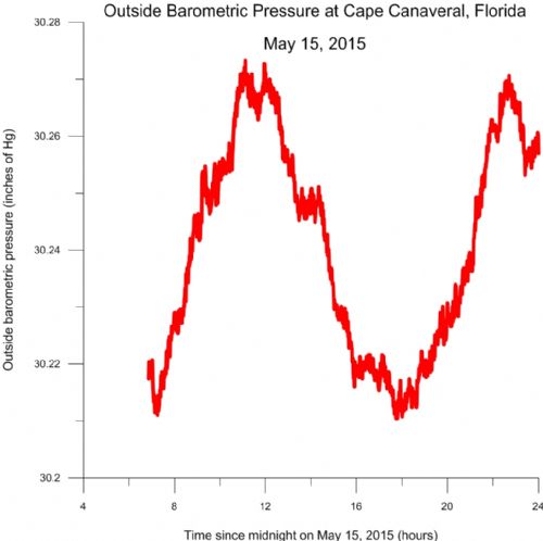

Posted: 07:57am 16 May 2015
Here are several plots created using data from the data logger. They illustrate outdoor atmospheric conditions yesterday, May 15, 2015, at Cape Canaveral, Florida.
It was an overcast day with rain showers several times during the day.
