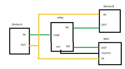

My troubles is the baud rate for the two devices is 57600, which only gives me Com1. With the 2 devices (A & B) talking back and forth, I want to sneak in the middle and submit my own serial data to deviceA the odd time. I'm thinking instead of reading DeviceB, and passing the data to DeviceA, I'll just use a relay or some type of IC switching chip. Default state is letting A and B talk back and forth. When I want to send my code, I'll turn on the switch, send my code, and turn off the switch.

  MolsonB said  I'll just use a relay or some type of IC switching chip. Default state is letting A and B talk back and forth. When I want to send my code, I'll turn on the switch, send my code, and turn off the switch.
That is also a very easy and cheap way to do it with some DPDT relays from eBay.
I did exactly that in one of my boards - switching COM1 between a paging transmitter, and a network module. It works beautifully, and the relay has the added bonus of a much lower on resistance then any of the mux chips I have looked at.
So long as only one device has to talk at any one time, then you can setup one relay for every device. External devices come in on relay NO contacts, and all the relay common's are paralleled up and connected to the COM port on the MM. When the MM wants to talk to a specific unit, it just pulls in that relay, does it's talking, and drops the relay back out again. This actually works extremely well, and is simple, so something ELSE to think about....

I have a relay sitting infront of me, but it's made for a circuit board and not breadboard. Was to lazy to solder wire onto it so I came on here instead. I really only need to control the TX line, so 1 relay with NO/NC would work just as easy (and cheap). Great thing is, without power, the system would run as desire with A and B talking.
