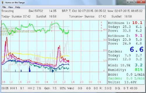

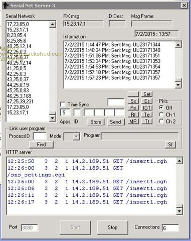

I have had a data logger written in VB6 collecting data from several clients running for a couple of years, weather, solar power, Greenhouse etc. These clients have previously been Picaxe mpu's but mostly ported now to maximite or more recently uMite. They all communicate via RF modules (XRF) to the PC running the VB6 program.

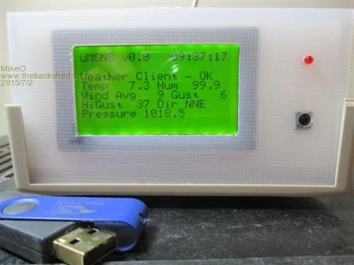

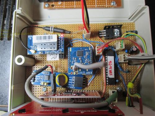

I have now completed a uMiteII version of the VB6 logger, it emulates many of the functions of the VB6 logger including the RF data collection, display, user interaction via IR and a web page. I have still to add uploads to my thingspeak channels and the weather station data to Weather Underground. The data protocol used is one based on the Serial power Network idea by Jurgen Kranenborg http://www.kranenborg.org/ee/picaxe/twowirenetwork.htm which I have found to be quite effective and reliable. My version uses a packet of 6 packed BCD 8 bit bytes allows for 2 way communication and is compatible with picaxe as well as Micromites etc. The web server uses matherp's remote thermostat code using the TLN13UA06 Wifi uart modified to include replaceable characters and page content length counter.
You can access the web page from the uMite currently http://203.147.99.198:8110/ and for interest also the VB6 page http://203.147.99.198:8080/sns_main.cgi

Here is a shot of the VB6 system busy collecting data.

One part of the system will be a TFT display touch screen fitted into a standard light switch plate, used for the normal display items of interest. This is something the BOSS is pleased about! (A rare thing indeed)
This is the 'old' display, written in Liberty Basic:
