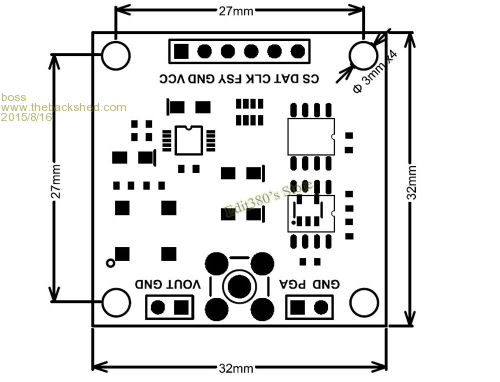

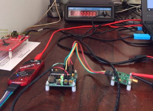

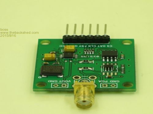

If someone of you is interested to build nice DDS Signal generator cover 1Hz to 12.5Mhz for less than $10, there is description how to do it:
Couple weeks ago I found nice AD9833 module with amplified output on eBay for $9.50 and free shipping. Simply connect the module with uMiteII via 3(SPI) wires (see instruction in DEMO programm) and 5V power, download the enclosed "DEMO" and enjoy.Because of DDS you must add the LP filter to reconstruct signal properly. Right now I'm working on LP filter design.

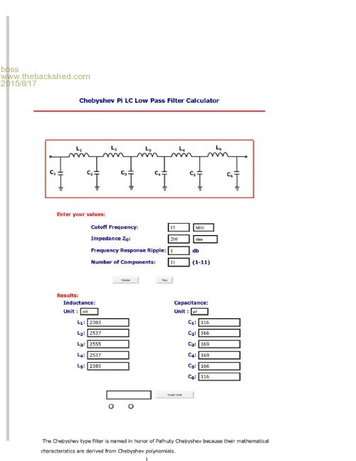

What is the LP filter that is required and does this need to be different for every signal generated?

LP filter means Low Pass filter and consist of 5 inductors ~2uH,6 capacitors ~250pF and one resistor 200 Ohm. The design is finished but LP response need to be verified with signal generator and oscilloscope.
Hopefully I can do it till end of this week. LP is connected to the DDS output connector.

there is the filter design
Bo
Posts: 2981
Posted: 05:15pm 16 Aug 2015
Ho Bohumil,
Is that in series with the resistor?
What sort of voltage level with this module put out?

No parallel to C6, but instead resistor I'm considering to use 200 Ohm potentiometer allows you control desired output level. For frequencies 1Hz-6250000 the output level is stable higher frequencies goes down with amplitude.

To the module signal: AD9833 can generate sinus, triangle and square signal. Sinus level p-p is around 3V for frequencies up to 6.25MHz, for higher frequencies the p-p level goes down. As simple and inexpensive signal generator is good enough. And there is possibility to ad another functionality ie. sweep generator just write the code.

The SPI interface has two chip select signals - FSY which, when taken low, addresses the AD9833 and CS which addresses the MCP41010 digital potentiometer (which is also in the module).
