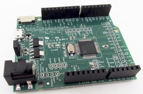

CircuitGizmos
Joined: 08/09/2011
Posts: 1427
Posted: 10:59am 31 Oct 2015
  Janosik said
  twofingers said  That's why Geoff made it better for the newer Micromites
I suppopse the guys at CG want to sell their old stuff first...
Do you have a link or so to those newer Micromites?
Maximites are different from Micromites.
You can update the CGCOLORMAX with the update software that Geoff has on his site. The CGCOLORMAX you have can be updated to Maximite formware version 4.5.
The CGMICROBOARD ( you can buy one here ) is a Micromite (not a Maximite) and the BASIC in a Micromite is more advanced.
Edited by CircuitGizmos 2015-11-01
