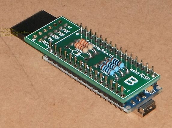

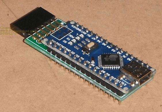

Hi folks.
With Robert's permission, I post this thread for a simple PCB for his ascii ICSP unit.
Note that I have not yet fitted the zener on the bottom, nor finished soldering the pins, but Robert has confirmed that everything works as it should. Note also that I have forgotten to push the pin-header pins through for the jumper on 5v-RST-GND pins, but next time......
Using Shenzhen2U's 100x100 service, you can get 100 of these PCB's for US$11.90, or 12c each!(ten panels of ten boards per panel)
With this PCB, the extra parts to go on it, and a Nano module, the entire programmer can be built for about US$5.
The 6p header strip can be had in lots of 20 for US$1.26 from eBay.
Here is the link.
The Arduino Nano is easy to find on eBay - just search for it, as there are many traders selling the module. Usual price is about US$2.50 per module including pin-strips.
Here is the ZIP file with the overlays and Gerbers, so anyone who wants to, can get their own boards made.
ZIP file with images, overlays and Gerbers

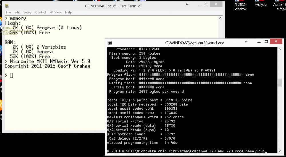

Posted: 12:13am 23 Dec 2015
Well, finally got around to fitting the elusive 3v3 zener(cos I did not have any till today!), and can report that the programmer goes fine, and I was actually surprised - it was faster then I thought by about 20 seconds.
Rob - any idea why that would be?
....not that I am complaining....
Posts: 2552
Posted: 03:09pm 23 Dec 2015
my feeling is that there is a great deal of 'idle' time spent in the USB drivers waiting for traffic to be sent and acknowledged. bearing in mind that the pathway consists of:
windows serial API -> USB drivers -> USB transport -> bridge to serial
the USB hardware is geared to either very small quantities of intermittent data (keyboard, mouse, etc) or very large blocks of data (disk drive). whereas pic32prog is throwing at it a vast stream of very small packets that the serial API is mixing up in who-knows-what-way. profiling the code reveals that pic32prog spends about 2 seconds processing data, with the remainder of the run time blocked by the serial API.
