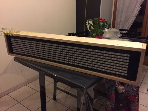

Very nice job. I did one on the same style during my christmas holidays but a little bigger (1 meter x 20 cm) with very bright RGB led strips.

This is the display itself:

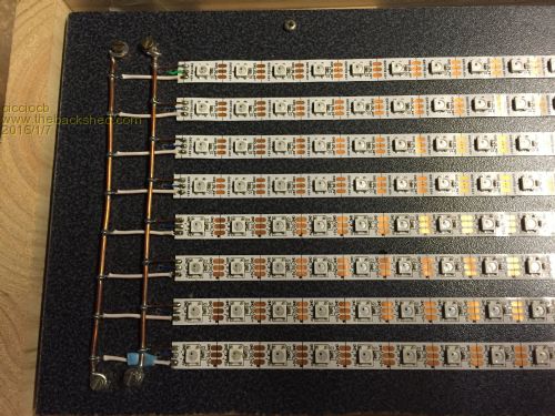

This is the detail of the led strips

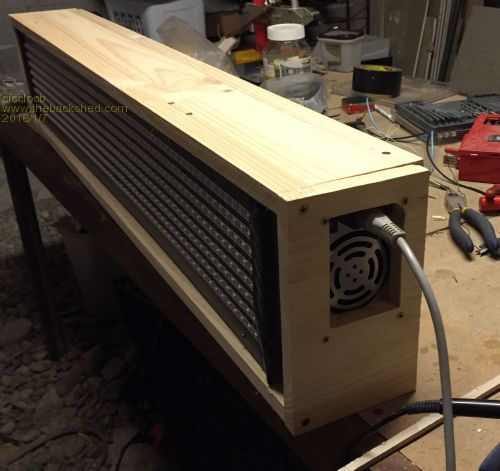

This is how is powered (with a PC power supply)

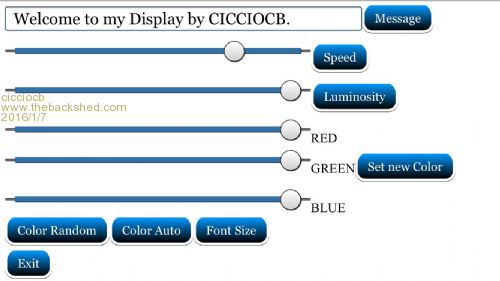

A snapshot of the web control page taken from my iphone

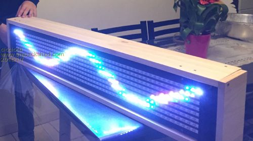

If you are really interested I can try to post a video showing the scrolling text.

The image is very bright, even outside in full day light conditions.
For internal use, the brightness needs to be reduced at around 5% of the full level.

I am curious as to how you control individual LEDs on those LED strips? Aren't all the LEDs on each strip in parallel?

all the leds are WS2812B.
The display is simply a long strip of WS2812B, all connected in a daisy chain configuration.
The total is long daisy chain of 8 strips of 60 leds (480 leds).
As you can see from the controller picture, there is just one wire that control the entire strip (the green one).
As each led needs around 50mA at full brightness, you can understand why I installed a PC power supply (50mA * 480leds = 24A and 24A * 5V = 120W!).
I can confirm that, if I drive all the leds at full brightness, the emitted light it's very very bright.
