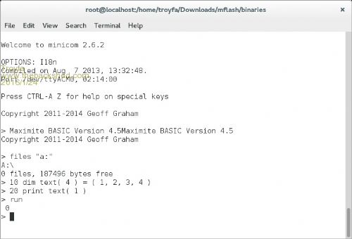

I updated MMBasic to version 4.5 for the Maximite/Minimite using mphidflash.. after the update I have noticed that the DIM statements aren't working for some reason..
heres a screen shot...
10 dim text( 4 ) = ( 1, 2, 3, 4 )
20 print text( 1 )
run
0

Hey I just noticed MMBasic is written twice...

Hi and welcome to the forums and MMBasic
V4.5 does not allow you to assign values to arrays when DIMing them
DIM TXT( 4 )
FOR n = 1 TO 4
txt(n) = n
NEXT n
PRINT TXT( 1 )
TEXT is not a keyword in V4.5 but is used in later versions for the micromite.
It would be safer to refrain from using TEXT as a variable name (but does not cause problems for now)
You can forget about using line numbers. They still work in V4.5 but it is better to learn to leave them alone, the sooner the better.
Seeing a double signon is not a problem, just a quirk of Linux and the USB-serial initialization. Windows users see that sometimes too.

I forgot to mention that when I edit code inside the built in editor.. it cannot save..
I press the F1 key, and it says... Do you want to discard changes (Y/N)...
Posts: 6624
Posted: 05:10pm 23 Jan 2016
I think minicom does things to the function keys.
You can use other control keys instead.
From the MMBasic manual:
  Quote  You can also use control keys instead of the functions keys listed above. These control keystrokes are:
LEFT Ctrl-S RIGHT Ctrl-D UP Ctrl-E DOWN Ctrl-X
HOME Ctrl-U END Ctrl-K PageUp Ctrl-P PageDn Ctrl-L
DEL Ctrl-] INSERT Ctrl-N F1 Ctrl-Q F2 Ctrl-W
F3 Ctrl-R ShiftF3 Ctrl-G F4 Ctrl-T F5 Ctrl-Y

I found that PuTTY is the only Terminal program on Ubuntu that will properly deal with the function keys. It will also display colour for Option Colour On in the later MM versions.

Thanks for that Jim.. yeah, that code works
I also found some code that is quite interesting...
dim txt( 4 )
data 10, 20, 33, 62
for n = 1 to 4
read txt( n )
next n
Thanks for the tip about the line numbers... and the keys.. i will give them a try...
