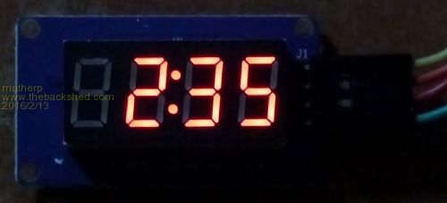

If you want a cheap and cheerful clock display you can't get cheaper than this
These displays use the TM1637 controller which has a i2c-like interface (pullups required on the clock and data leads)
The attached code drives this display using simple bit-banging from Basic (not a CFunction in sight)

This is a very cost effective display. I am wondering what the protocol is and why it is different that I2C. Can't find too much data on this one. Thanks for the code, just ordered a couple of these to play with.

endif
setsegments(displaydata()) 'update the display
mytime$=time$
endif
loop while timer <60000 'update the time over a minute
for j=-999 to 1999 step 17 'demo positive and negative numbers without leading zeroes
convertnumber(displaydata(),j,noleadingzeros)
next j
for j=-999 to 1999 step 17 'demo positive and negative numbers with leading zeroes
convertnumber(displaydata(),j,leadingzeros)
next j
end
sub TM1637Init(pinClk as integer, pinDIO as integer)
dim integer m_pinClk,m_pinDIO
' Copy the pin numbers
m_pinClk = pinClk
m_pinDIO = pinDIO
' Set the pin direction and default value.
' Both pins are set as inputs, allowing the pull-up resistors to pull them up
pin(m_pinDIO)=0
pin(m_pinClk)=0
setpin m_pinDIO,DIN
setpin m_pinClk,DIN
end sub
sub setBrightness(brightness as integer)
m_brightness = brightness
end sub
sub setSegments(segments() as integer)
local integer k
' Write COMM1
sendstart
writeByte(TM1637_I2C_COMM1)
sendstop
' Write COMM2 + first digit address
sendstart
writeByte(TM1637_I2C_COMM2)
' Write the data bytes
for k=0 to 3
writeByte(segments(k))
next k
sendstop
' Write COMM3 + brightness
sendstart
writeByte(TM1637_I2C_COMM3 + (m_brightness AND &H0f))
sendstop
end sub
sub sendstart
setpin m_pinDIO, DOUT
' bitDelay
end sub
sub sendstop
setpin m_pinDIO, dout
setpin m_pinClk, DIN
setpin m_pinDIO, DIN
end sub
sub writeByte(b as integer) as integer
local integer i,ack,odata = b
' 8 Data Bits
for i=0 to 7
' CLK low
setpin m_pinClk,dout
' Set data bit
if (odata and 1) then
setpin m_pinDIO,DIN
else
setpin m_pinDIO,DOUT
endif
' CLK high
odata = odata >> 1
next i
' Wait for acknowledge
' CLK to zero
setpin m_pinClk, dout
' CLK to high
setpin m_pinClk, din
ack = pin(m_pinDIO)
if (ack = 0) then
endif
end sub
function encodeDigit(digit as integer) as integer
encodeDigit=digitToSegment%(digit and &H0f)
end function
sub convertnumber(dd() as integer,n as integer, nolead as integer)
local integer d(2),m
m=abs(n mod 10000)
if n<0 then m=abs(n mod 1000)
d(0)=(m - (m mod 1000))
d(1)=(m - d(0) - (m MOD 100))
d(2)=(m - d(0) - d(1) - (m mod 10))
dd(3)=encodeDigit(m - d(0) -d(1)- d(2))
dd(0)=encodeDigit(d(0)1000)
dd(1)=encodeDigit(d(1)100)
dd(2)=encodeDigit(d(2)10)
if nolead then
if d(0)=0 then
dd(0)=0
if d(1)=0 then
dd(1)=0
if d(2)=0 then
dd(2)=0
endif
endif
endif
if n<0 then
if dd(2)=0 then
dd(2)=64
else
if(dd(1)=0) then
dd(1)=64
else
dd(0)=64
endif
endif
endif
else
IF n<0 then dd(0)= 64
endif
end sub
sub converttime(dd() as integer,displaycolon as integer,nolead as integer) as integer
local integer i=val(left$(time$,2))*100+val(mid$(time$,4,2))
convertnumber(dd(),i,nolead)
if displaycolon then dd(1)=dd(1) OR &H80
end sub
