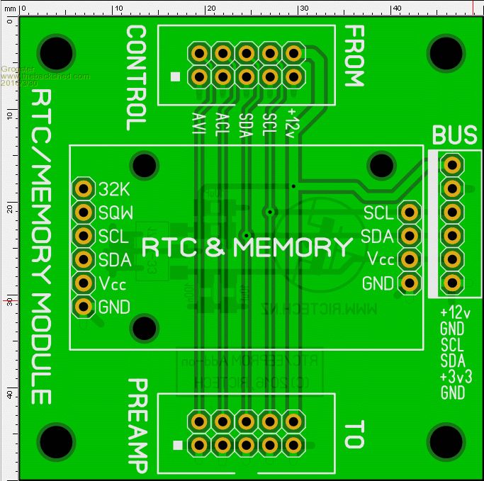

EDIT: OK, here is an image of my simple RTC carrier board:

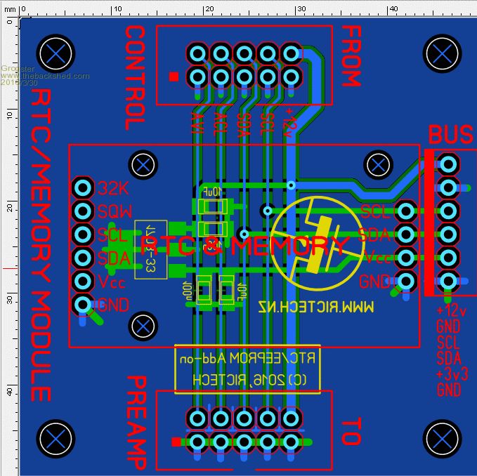

Now, using photoview(down bottom of left-side menu), it will look like this from the PCB house:
Note how the three vias between layers are covered in soldermask like the rest of the board - you can't solder to these, they are covered up as they are just vias. Pads can also act as vias too, but solderable ones.

EDIT: Same board but with the vias NOT clicked with the mouse using the SOLDERMASK menu option on the left:
Note how these vias would show up as solderable pads from top or bottom.
There is no need for that, so I cover them all up, if you see what I mean.
There is no reason why you can't leave them all as solderable vias if you like - this is just what I like to do, but is by no means scripture.Edited by Grogster 2016-03-31

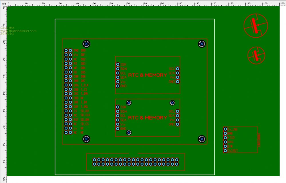

The easiest way FOR ME that I have found, is to set the board dimensions larger then the board you are planning to design, then adjust the OUTLINE layer to suit. The PCB house will use the outline layer, to set the actual size of the board, regardless of the size you set in NEW BOARD.
Example:
Note that the board size is 160 x 100, but the outline is set to 93 x 91 - the white outline box. If you sent this to the PCB house, they would make the 93 x 91 bit, and ignore the rest outside that white box - the PCB would comply with the 100 x 100 spec for $12 at SH2U, in other words, despite the board size being 160 x 100 if you see what I mean.
You can then adjust this outline in both the X and Y dimensions to enlarge or shrink your board size to suit whatever you are laying out.

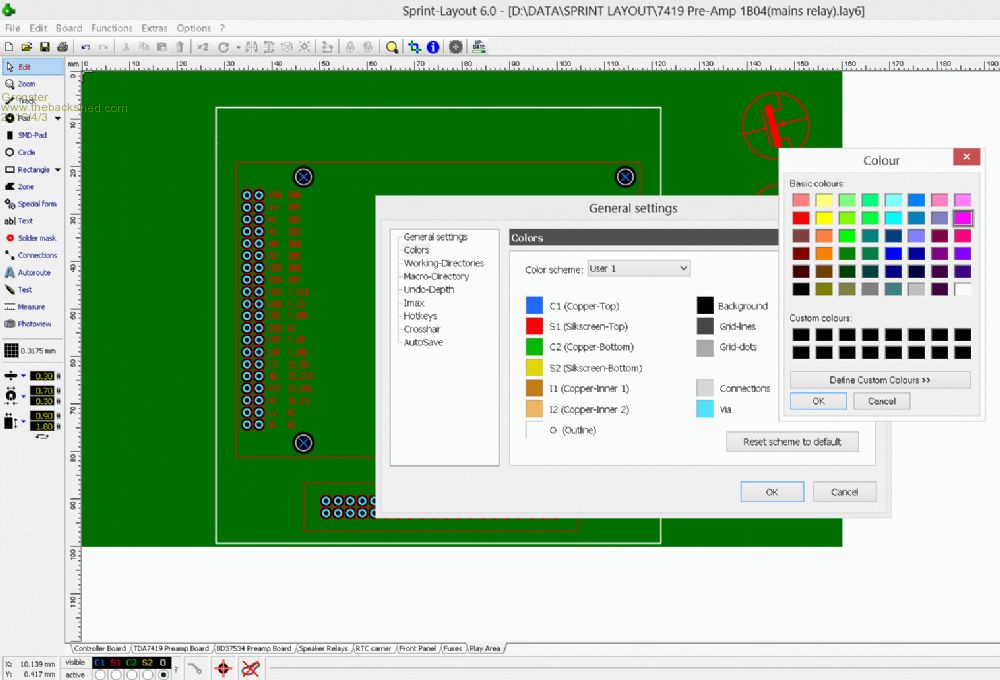

EDIT: I prefer to set the outline layer colour to magenta rather then white. Again, this is just me. The reason is that this then allows me to easily see an outline image for the board that I draw on the silkscreen, and then the magenta actual outline layer outside that, so that when they make the board, you can then have a nice neat white outline on the silkscreen layer which finishes off the board nicely.
You change that colour if you want, in OPTIONS/GENERAL SETTINGS/COLORS.
