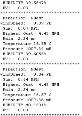

I've been reading the manual about this and I'm totally confused
I understand that if I want to print a number it can be a certain number of digits before or after the decimal point
but what do you do when you want to print the value of a "label"?
for instance in the wind speed program I'm trying to sort out
wSpeed=(windfactor*reading)/(testpause/1000)
I can do this
PRINT wSpeed "" and it will print the speed, but how can I tell it that I only want it to 2 decimal places?
OR how can I limit wSpeed to 2 decimal places?

Posts: 12026
Posted: 08:03am 27 Jun 2016
Same as above - use STR$
print STR$(wSpeed,3,2)
If you wanted to actually adjust the number you could use
wSpeed= CINT(wSpeed*100)/100.0

Got it working with everything apart from bme280_read_humidity but I can live with that Edited by lew247 2016-06-28
lew247
Joined: 23/12/2015
Posts: 1709
Posted: 09:01am 27 Jun 2016
Thanks Peter, works great
