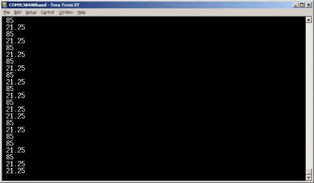

I have a waterproof probe version of the DS18B20 connected to a 170 with MMBasic 5.1
Here is a code snippet:
TRTEMP=DS18B20(2)
Print TRTEMP
WRITE_DISPLAY
Pause 1000
This is an example of the readings:
Can someone give a reason for the 85 readings?

what is the line:
WRITE_DISPLAY
supposed to do? if it contains a leftover print statement, that could be the culprit!
try changing the line:
Print TRTEMP
to:
Print TRTEMP; " degrees"
so that you can be 100% sure where the '85' is coming from.

Rob the WRITE-DISPLAY sub outputs the reading to a set of 7 segment displays and the 85 appears there as well.

Do you have a 4K7 pullup on the DS18B20 data line?

How does the WRITE-DISPLAY sub 'get' the number to be displayed ?

@ Peter yes I do have the 4K7 pullup on the pin.
@ John the code to display the temperature reading on the 7 segment displays is fairly convoluted as I have 2 and 1/2 digits plus two decimal points and it auto ranges from 0-1.99/19.9 and 199. Each led segment is directly driven by a pin on the micromite.

How does the variable TRTEMP get to be used by the subroutine WRITE_DISPLAY .
Consider posting the first dozen or so lines of the subroutine.

Found the problem. The error was caused by the cpu speed not being consistent. As I intended to run the device on batteries I was putting the micromite to sleep and waking it up for some time to present the reading. If I recall I had this issue some time ago and corrected it with cpu speed it is just that this time it presented in a different way giving the 85 reading.
