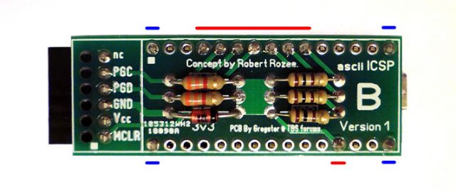

Posts: 2552
Posted: 04:23am 12 Jul 2016
does your assembled board look much like this one?
note the pins that MUST be soldered, indicated by red lines - 7 along one edge, and one on the other edge. the 4 corner (blue line) pins are just for mechanical support. when i first assembled one of grogster's boards i forgot to solder pin 4 and had no end of problems!
also be sure that the zener diode is the correct way round.
Posts: 10065
Posted: 05:54pm 12 Jul 2016
I solder ALL pins, even though that is not technically required. That saved me having to worry about which ones I needed to do, and which not to bother with. If you solder them all, you are covered no matter what.
My 2c only.

Posts: 2552
Posted: 01:59am 13 Jul 2016
would you mind posting a photo of the board you have assembled? apart from assembling the nano onto the wrong side of the board (nano goes on side "A", resistors and zener on side "B") there is not much that can go wrong. and the 328p processor itself is pretty tough, so poking around with meter leads is unlikely to cause damage.
