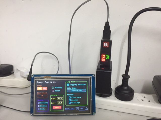

Also noticed Geoff mentions around 500mA with a 5".
Measured what mine was drawing yesterday, with just RTC & screen,
All that was running was the pump demo.
Got 490mA on a USB ammeter.
Didn't try turning brightness down,
got side tracked by the fact that the USB Com12 wouldn't work.
Turned out the PC was shutting down the ports data service at the level of current draw.
Phil.

Strongly advise using a PSU rather than a computer port when using an E100 with a TFT connected (no matter what size TFT).
It is worth obtaining a Raspberry Pi official PSU - they are cheap and of decent quality; and will deliver more than enough current for a 'loaded E100 set-up.

You could use a USB3 port if your PC has one. It is capable of much higher currents. USB2 - 500mA. USB3 - 1.9A. However, your standard USB cable is going to be marginal at best trying to supply these sort of currents. I very much doubt that you will have the full 5V, at the MM+ end, due to voltage drop within the cable.
Personally, I use an external PSU, and a purpose made cable, for things like this.
The USB, dual port, 'wall warts' (Zonker will know what that is) are ideal.

Completely agree with mikeb on that. Especially about the USB cable and voltage-drop.
This is one of the reasons we changed the power input from a uSD connector, to a DC socket.....

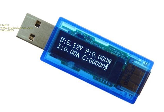

It was just a quick & easy way to measure current with one of these:-
It was handy; no effort required, Lol.

mikeb
Joined: 10/04/2016
Posts: 180
Posted: 07:26pm 24 Aug 2016
That's a nice looking one Phill. Beats my LED one.
