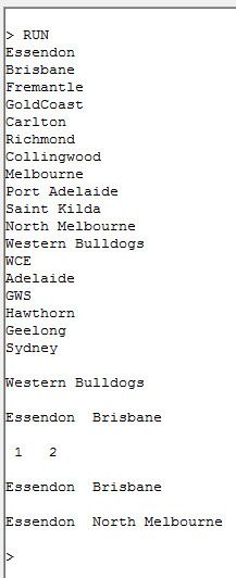

I think it would be a lot easier if you change the format of your data.
Essendon = 1
Brisbane = 2
Fremantle = 3
GoldCoast = 4
Carlton = 5
Richmond = 6
Collingwood = 7
Melbourne = 8
PtAdelaide = 9
StKilda = 10
NorthMelbourne = 11
WesternBulldogs = 12
WCE = 13
Adelaide = 14
GWS = 15
Hawthorn = 16
Geelong = 17
Sydney = 18
DIM STRING city.name(18) = (" ","Essendon","Brisbane","Fremantle","Gold Coast","Carlton","Richmond","Collingwood","Melbourne","Port Adelaide","Saint Kilda","North Melbourne","Western Bulldogs","WCE","Adelaide","GWS","Hawthorn","Geelong","Sydney")

This is the output:
