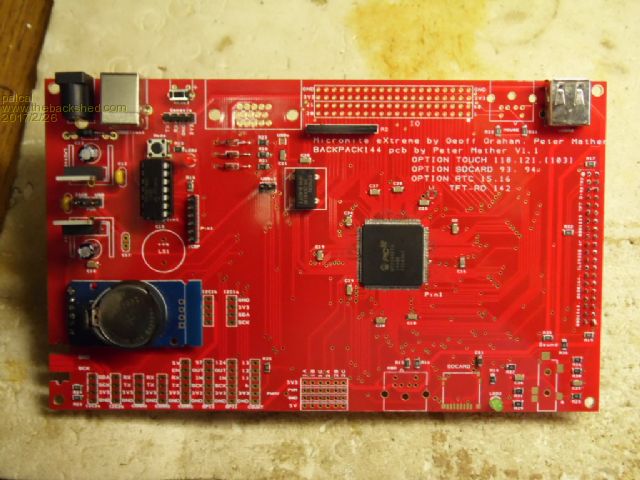

Looking good there PalCal
Just in case you've not noticed, I recommend adding the other 1uF cap in the power circuit. Also IF you're using an external PSU then try limit it to 7.5v max, and certainly add a heatsink on the 5v vReg if using external PSU.Edited by WhiteWizzard 2017-02-27
palcal
Joined: 12/10/2011
Posts: 2053
Posted: 10:48am 26 Feb 2017
Thanks WW the other 1uf is on its way and I alway only use the minimum voltage possible to minimise heat dissipation.

I can't find any information on the 'MODE' button. I see it cycles from PROGRAMMER, MONITOR, CONFIG, USBSERIAL. Is there an explanation of it's use somewhere.
Paul.
Posts: 2994
Posted: 03:14pm 26 Feb 2017
@palcal
I have taken the following extract from Rob Rozee & Grogster's excellent Explore 28 Manual:
The 'MODE' button performs the following functions:
1. when in serial mode, a brief press will place the 1455 into ICSP mode. The status LED will
light and remain lit while in ICSP mode.
2. if in ICSP mode, a long press (2 seconds) will extinguish the status LED and return the 1455 to serial mode.
3. while in serial mode, a long press (2 seconds) will briefly flash the status LED and upon release of the SELECT button the 1455 will reset the MX170.

Mine does not seem to operate like that, as I said it has 4 modes. I had trouble programming a new chip, kept getting the "Device does not match' so I used the chip I had in Peter's TFT Backback.
Which file am I supposed to load into the 1455, I'm trying to find my old PicProg programmer, never had any problems using that.
Looked for the Explore 28 manual with no success, TBS is getting very untidy there are bits of everything all over the place. We need a special place to keep code and manuals etc.
Paul.

@palcal,
I will email you in a short while with the very latest hex file that is required for the 1455 (and operates as per my post above).
Will laso confirm 'connections' to program the PIC1454/5 with just a PicKit
Give me an hour . . .
WW
Paul.
see:
http://www.thebackshed.com/forum/forum_posts.asp?TID=9348 (thread)
http://www.thebackshed.com/forum/uploads/robertrozee/2017-02-23_120846_E-28_blurb.pdf (direct link to PDF)
for the current 3-page E-28 manual.
and:
http://www.thebackshed.com/forum/forum_posts.asp?TID=8903&TPN=2 (thread)
http://www.thebackshed.com/forum/uploads/robertrozee/2017-02-08_134027_1455_v1.18_inc_ds30.zip (direct link to ZIP containing .hex file)
for the latest (1.18) binary image - source code is in thread.

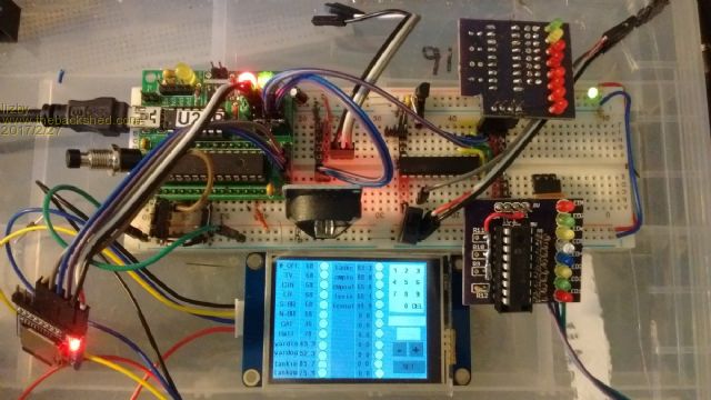

As the i/o for the newer micromites begins to look more and more like the back of a PC motherboard, I tend to think it's overkill for my needs--but others have different needs, and more power (literally) to them.
Got my appetite whetted, though. I'd like to see an Extreme-44 like the Extreme-28. I wouldn't hold out a hope that anyone would get rich off of it.
BigMic--still just playing, but I love what can be done with the MuPv3. Like this xmas tree. Thanks to White Wizzard for pointing me in this direction.
