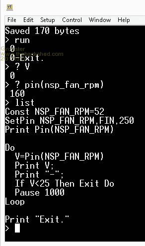

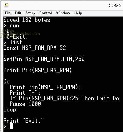

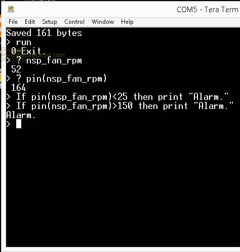

This is strange, and I can't make it work INSIDE a running code.
If I ask for the result on the pin with the fansink fan tach on it AT THE COMMAND PROMPT, it works fine. The result is as expected.
If I ask for the result inside any running code, the result is ALWAYS zero:
Code that demonstrates this issue:
Const NSP_FAN_RPM=52
SetPin NSP_FAN_RPM,FIN,250
Print Pin(NSP_FAN_RPM);
Print "-";
If Pin(NSP_FAN_RPM)<25 Then Exit Do
Pause 1000
Print "Exit."
Note that from the command-prompt, I can issue the IF/THEN, and it works.
But inside a running code, it will not.
Removing the 250ms gate time from the SetPin command makes no difference.
If you put Print Pin(NSP_FAN_RPM) after the SetPin command, but before the loop, the result is also zero:
If it IS something I am doing wrong, I would love to know what it is, but.....
Houston - do we have a bug?

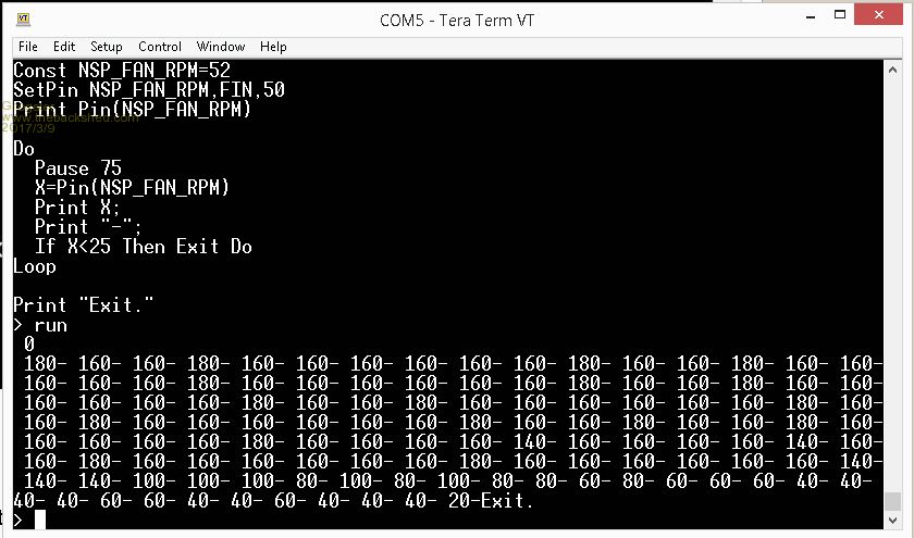

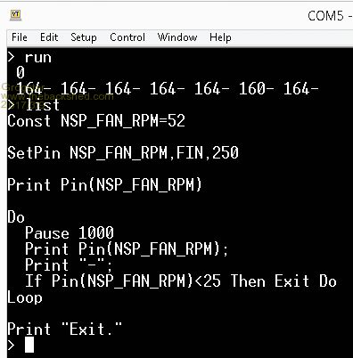

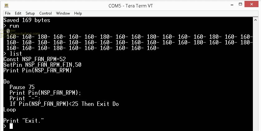

Posts: 10052
Posted: 10:07pm 08 Mar 2017
This code snippet is from a much much bigger code, just to isolate this specific issue. This code does nothing useful, other then demonstrate the problem.
Will try adding a pause.....
....you might be onto something here:
Looks like you DO INDEED need a pause of some description directly before or after the command to make it work. Note how the first one is still zero - the one before the loop starts, then all subsequent loops work.
I had a PAUSE 1000 at the end of the loop, so all I did was move it to the top of the loop, and it works now - interesting.
EDIT: Yes, you need to pause at least the time specified in the SetPin command - 250mS in this case. If I pause 250, it works fine. If I pause 249 or less, I get zeros.
EDIT: Fine tuning of the delays results in a nice rapid-fire output - plenty fast enough for my purposes. I will make suitable changes to the big program and hopefully that will fix it.
Testing proves that you MUST put the pause before the command to read the pin. Placing the delay anywhere else - like at the end of the loop - results in zeros.
This would appear to be the work-around, but I would still like to know if this is considdered normal behaviour for this command.
Edited by Grogster 2017-03-10

The above is ONLY AN EXAMPLE to show the problem. It does not reflect the actual layout of the code I am trying to use it in. The problem is the same regardless of if it is in the "Big" code, or in the examples above - the error results are exactly the same.
I have added a 25mS pause in the main loop, just before the command to read the FIN pin, and it now works fine. I reduced the gate time in the SetPin command to 10mS.
