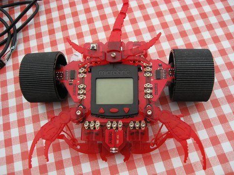

Whilst having a shed cleanout (an on-going saga!) I recently came across a box containing various assorted bits and pieces for a couple of robot kits made by a South Oz company called Microbric.
One of these robots, called the I-Bot, was released as an educational project by the Advertiser newspaper in association with Tafe SA and the two SA unis back in 2008. I can't quite remember the details for the other AI2 robot which came out around the same time but it was also made by Microbric but was more sophisticated with an LCD display and could be programmed by a USB cable from a computer. More info on these is available by searching online for “Microbric”
Anyway, I figured I would see if anything workable could be resurrected from the bits for my grandson, who was just getting interested in codeing at primary school, and soon managed to get a functioning AI2 robot.
Since all of the inbuilt routines from its internal memory seemed to work OK I downloaded the BricWorks program from the website to see if it could be programmed via downloading.

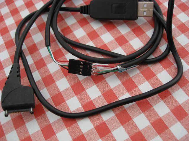

Now for the next hurdle – the programming cable which was no longer available from Microbric.
A search of their website revealed that a Nokia DKU-5 phone cable should work, and I soon found one of these at the local op-shop (for 20c!). But, when I tried it, no-go!! After a lot more searching online it turns out that I had a genuine DKU-5 but I needed a 'knock-off' which used the PL2303 chip. To get around all of the confusion I bought a cheap USB to RS232 cable online and spliced the Nokia plug to this. With the appropriate drivers installed I soon had a cable capable programming the Ai2 robot.

BTW, the AI2 robot uses a Zilog Z8F0823 micro and the I-Bot has an MC68HC908.
The Microbric system uses circuit board modules which bolt together to build projects a bit like the old Mechano.
Their latest offering is a robot system called Edison which is evidently compatible with the Lego robotics.
