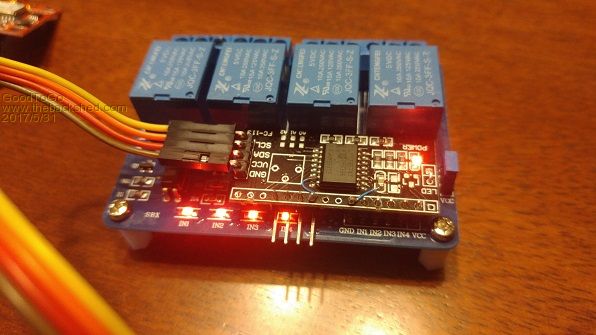

Those little I2C modules with the PCF8574 are great. I, like Phil23, use them on a 20x4 module. The code is a bit unwieldy, I admit. It would be great in a Cfunction. However when it comes to C, it's all uint_string {Greek} to me. Anyone want a go at it? I can supply the Basic routines I use....
I've also bolted a modified one on to a 4xRelay I have here to turn it into an I2c Controlled Relay Module:-
The four extra pins are the remaining 4 I/O's from the PCF8574 to use for whatever I desire.

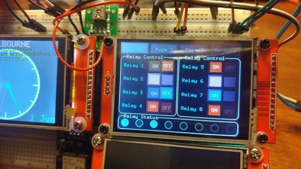

The code is based on Phil23's Spa paging code and I squeezed the GUI layout onto a 2.8" MM+ LCD Backpack:-
I find the buttons are workable for my fingers.
I've also adapted an 8x Relay unit I have as well, but utilising a slightly different I2c module. (Hence why the GUI above is for controlling 8 relays )
Controlling a bunch of stuff using only 2 pins comes in handy.

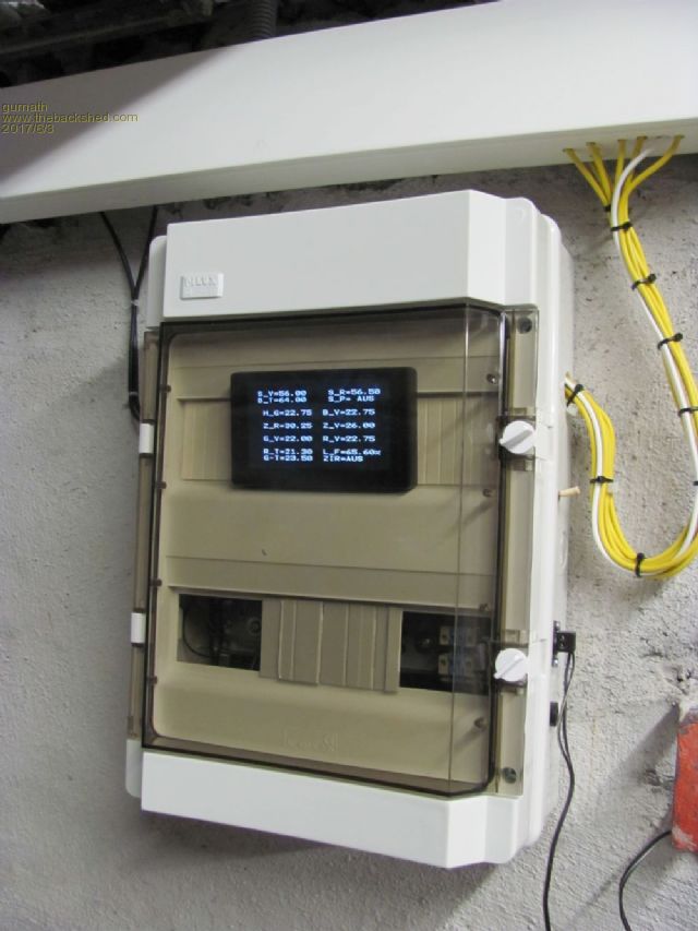

@ Phil23
Hello Phil,
Since I still have many MX-150 left, I block these to VT-100 ads
(See Geoffs website), and use cheap displays for the ad.
This is a complete monitoring, our heating system and hot water system, with solar support.
The small display is only switched on when I am present in the boiler room.
Directed over com2 the MX-170, 28Pin.
9 x DS18B20
1 x DHT22
1 x relay input solar pump
1 x relay output, for controlling the circulating pump for hot water (bath, etc.)
1 x MAX 232, connected to the CONSOLEN interface for data transfer to my shack
The evaluation, and display of the temperature data, etc. is done with a
TFT-Maximite, (converted by me to a color maximite), to a large one
Display.

Thanks Guenter, seeing such a brilliant implementation of the technology makes all the work on MMBasic worthwhile. Just what I was hoping for when I set off on this path.

Hello Guenter - as Geoff said, this is an impressive project. Can you tell me what type of display you are using there - and a link if possible?

@paceman, Hello Greg
I always refer to these displays from Amazon.de.
Look for "Mini Display" or "Mini Monitor".
Costs just under 20 euros.
Best regards, Guenter
@ Geoffg, Hello Geoff
Thanks for the commendation, I give back.
The system runs continuously, without interruption, and fault over a year.
The hot water circulating pump ran before, almost all day from 6am to 22h.
Through the monitoring I have seen how often the heating the boiler needs to heat up.
The circulation pump now switches on via a relay at 30 degrees Celsius
And over 39 degrees off again.
Through this procedure, I have been able to reduce the number of heaters by a third.
This alone saves in the winter, when with us the solar system nothing supplies a large quantity natural gas. And of course a lot of money.
