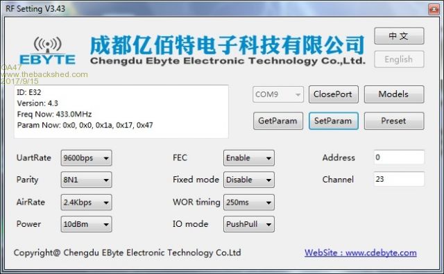

Srnet:
Here is the config screen. The only change I have made is the output power which was set at 20dbm out of the packet.
Posts: 10056
Posted: 03:08pm 15 Sep 2017
Cool, keep us updated!
You would probably increase reliability and range if you drop the "AirRate". It does depend on how many bytes you are sending though.

Ah IC.
That effectivly just defines a baud rate, I would have an idea of the potential range if I knew the bandwidth, spreading factor and code rates in use.
