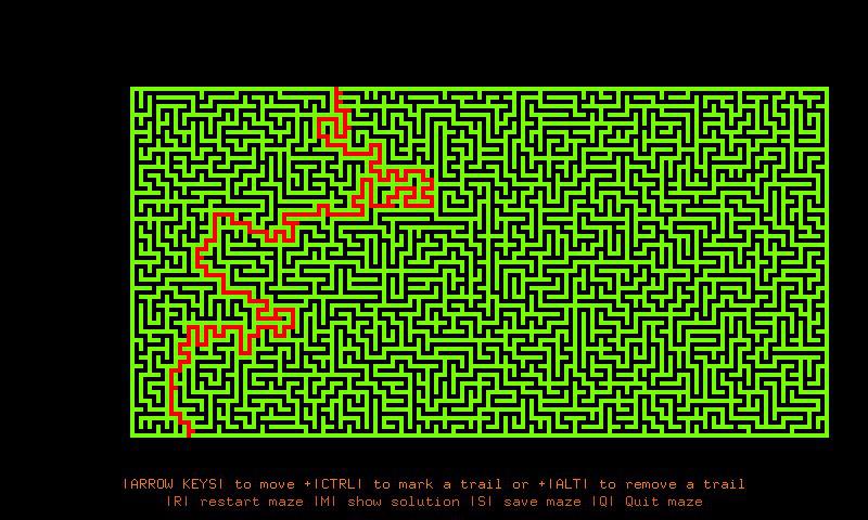

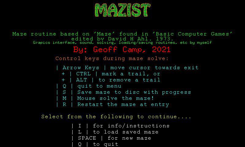

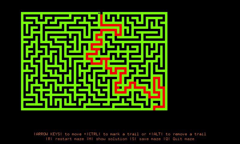

MAZIST v0.9 - A maze generation and solving programme for the CMM2
I originally wrote a maze generation programme on the Atari ST. It was also based on David Ahl's routines in 'More Basic Computer Games' but modified to be graphically based and mouse controlled. I used STOS - a beautiful Basic language with easy music & sprite routines built in - to write that and it was released as shareware under the Undersoft label.
Before I had the Atari I had an Amstrad 464, and later a 6128. Loved these machines and programmed quite a bit in basic and taught myself some z80 machine code as well. In 2020 I was looking for something to stimulate my retired brain so I re-wrote the program in Amstrad basic but it was painfully slow - 5 minutes for a 69x49 maze. So I got my mind exercise by converting the basic to z80 machine code and a this version was released as Masist2 on the CPC.
I heard about the CMM2 on 8Bit Guy's You Tube channel and it looked very interesting and in March this year I finally brought one. My first instinct was to write a program I'm familiar with but with more bells and whistles - hence a maze program based on David Ahl's routines. It's been a good exercise in introducing me to the CMM2 and its version of basic.
This version is not finished! It certainly is functional for what it is meant to do but there is more work to do. I should add more sound and/or music, maybe more graphic bells and whistles, and I need to fully utilize CMM2's Basic commands in the Maze routines as they are pretty old school, but they work. This just seemed a like a longer term job now that I have a working program.
On the good size... mazes can be from 10x10 to 99x69 and are generated very quickly. The solve routines also run very quickly. Up to 9 mazes can be saved for later solving. Trails can be marked on the maze and these are saved with your saved maze as a means to aid solving a maze in several sessions.
A maze solve routine will step through the maze and find the only solution if you are stuck.
Enjoy, and feel free to send any advice, hints, criticisms my way - I have broad shoulders and am a learner as far as modern Basic goes.
Geoff

This is a nice game.
It is a little bit difficult to see as the passageways are quite small, although a lot of maze can be
displayed on screen.  A zoom in/out option would be interesting.  Would like to see an option to create mazes which span multiple screens.  Multi-level mazes with up and down ladders is another idea.
The ability to navigate the maze in 3D would be a pleasant addition.

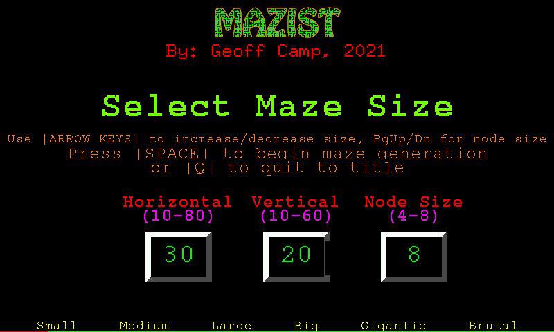

I've now added a zoom mode that can be turned on/off as needed. Also changed the Mouse Solve routine where you can either watch the 'mouse' find its way through the maze or just get the solution as currently used. Just got some code tidying up to do and to make sure new code hasn't messed anything up. I'll post the update soon.

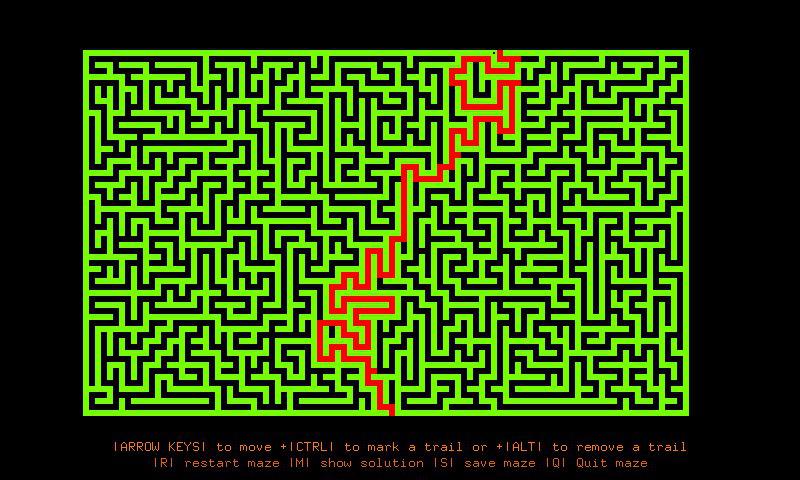

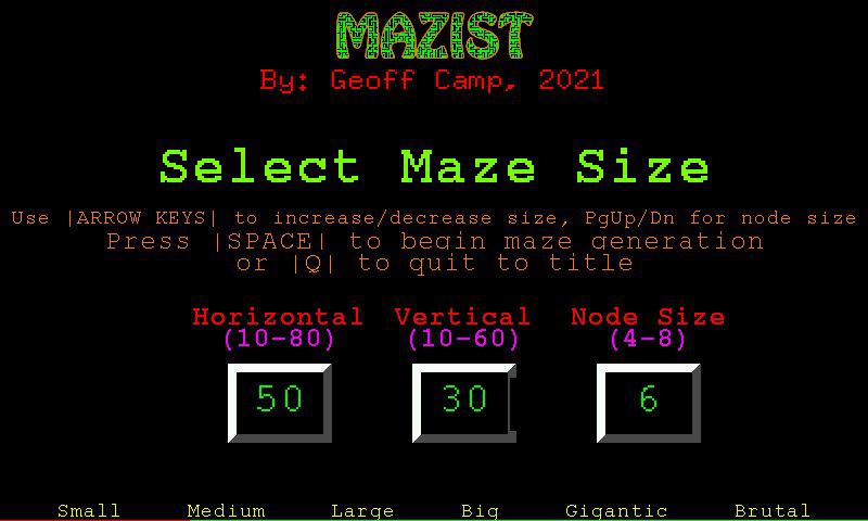

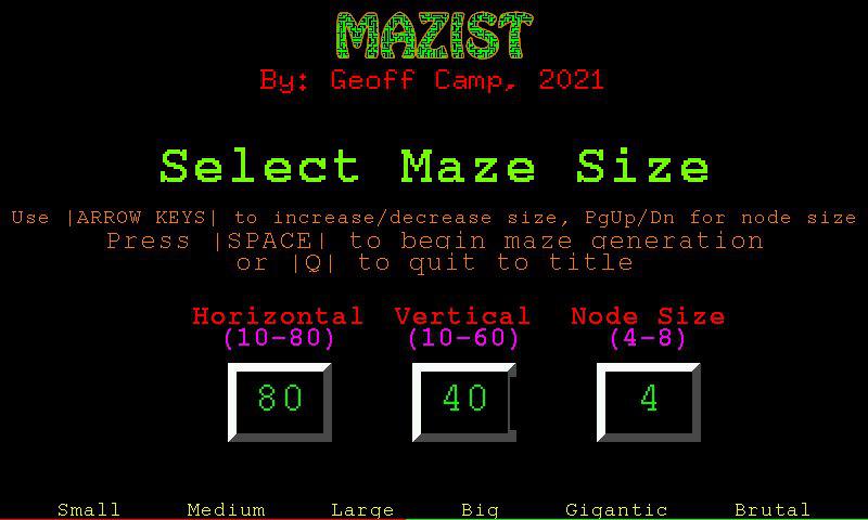

Looking forward to it. Unfortunately, what it means is that I have made a fork with the code I'm uploading here. What this does is
1) allow control on the CMM2 with either plugged-in keyboard or the PC console
2) allow it to run on the Armmite F4 with the IPS/OTM8009A 800*480 LCD.
3) allow changing of the "node" size from 4 to 4, 6, or 8. The node size is the size of the square block of pixels making up one of the two node types--barrier (green) or pathway (black).
Here's what it looks like on the F4:
An 8-pixel node size version--selection screen and solved:
6-pixel node size version--selection screen and solved:
4-pixel node size version--selection screen and solved:
The trickiest part of the port was incorporating the node size (variable sz) into the x and y coordinates for each drawing of a node.
For making the program work on the F4 and on the CMM2 with either keyboard or PC console, I replaced all the KEYDOWN functions with _KEYDOWN and provided a FUNCTION _KEYDOWN which looks for the Escape sequence for arrows and pgup/pgdn which the console and F4 use. I didn't implement ALT+(arrow) or CTRL+(arrow).
One happy discovery was that the MAP function available on the CMM2 could, for most uses in this program, be replace with an array named "map" on the F4, with no changes to syntax for most CMM2 map commands. For instance, "Colour map(cLtGreen)" works perfectly well on the F4 when map() is an array.
This does mean, however, the cool color flashing with MAP on the CMM2 signaling success is not available on the F4--where all the pixels would have to be redrawn--on the CMM2, the  VGA refresh provides the magic with MAP.
GUI CURSOR is not available on the F4, but is easily replaced with "box sx,sy,sZ,sz,,rgb(red),rgb(red)" (or black). No GUI CURSOR magic is used in this program, so if compatibility with other micromites is desired, it should be replaced with the box command.
"PRINT @" is not available on the F4, so I had to provide alternatives with TEXT. If PRINT @ were implemented on the F4, it would have to imply print to the LCD, not to the TeraTerm (or other) console, so possibly not worth the hassle.
I briefly backtested without encountering errors on the CMM2 with VGA-to-HDMI-to-USB3 on my PC.
This was a fun project, and more complicated than I had imagined. Hope the forking doesn't cause too much grief.
Zipped program and BMPs attached. Hope I didn't omit anything.
