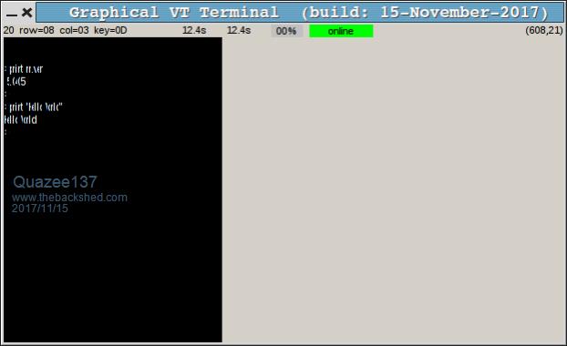

Just ran it under wine here is a screenshot
not sure the cause of the missing pixel columns.
will be nice to have 4 to 6 of these running and talking to my mites
any way to put the com : baud in the title area or may name it.Edited by Quazee137 2017-11-16

Quazee137: regarding running under linux/wine, i am quite surprised it got as far as it did! under the hood, GFXterm employs some pretty odd stuff that is very wine-unfriendly. from your screenshot it looks like the overlaying graphics objects are not stacking one on top of another; this is likely a limitation of wine. however, since GFXterm is written in Delphi there is no reason why someone couldn't port it to a linux native application using Lazarus:
https://www.lazarus-ide.org/
rob :-)Edited by robert.rozee 2017-11-18
