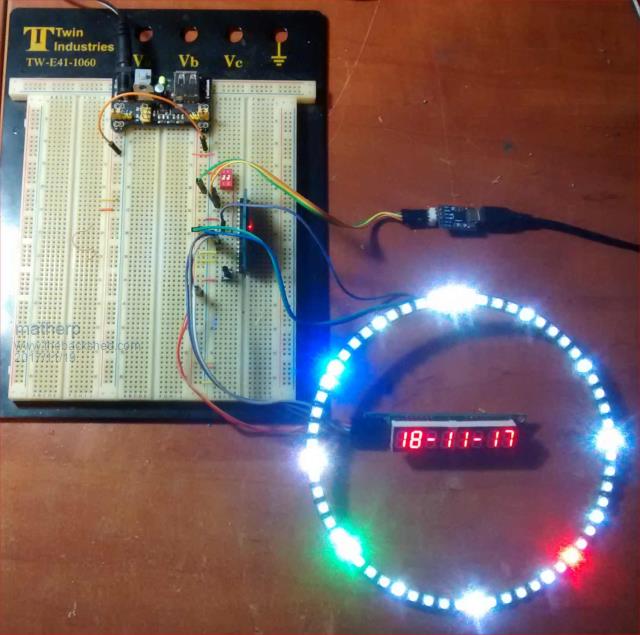

Something completely different
Behind dark smoked perspex 7:17:38
Development environment
This little development uses an ESP8266 programmed with the Arduino IDE.
The ESP8266 connects to my WIFI and downloads the current time and date from an ntp server every 10 minutes. In between the time is updated on the NEOPIXEL ring from the ESP's crystal oscillator. Red is the seconds, blue the minutes and green the hours. The clock automatically compensates for daylight saving. The Date is shown using a MAX7219 7-segment LCD display
Getting the ESP8266 up and running with the Arduino IDE is simple - just google. I then use a standard USB/UASRT to program the ESP. As always with the ESP GPIO0 must be connected to GND to program and then the chip RESET.
The code is attached. It is currently somewhat UK/Europe specific in terms of the summertime calculation but this is easily modified.

previousMillis = currentMillis;
// It's time to do something!
// Use the snapshot to set track time until next event
if(done)epoch++;
DST=epoch;
DST+=(timezone*60);
if(summertimeUK(DST)) DST+=3600;
tm=gmtime((const time_t*)&DST);
for(int i=0;i<NUMPIXELS;i++){
pixels.setPixelColor(i, pixels.Color(1,1,1));
if(!(i % 5))pixels.setPixelColor(i, pixels.Color(10,10,10));
for(int i=0;i<NUMPIXELS;i+=15){
pixels.setPixelColor(i, pixels.Color(70,70,70));
pixels.setPixelColor(59, pixels.Color(30,30,30));
pixels.setPixelColor(1, pixels.Color(30,30,30));
hourpos=(tm->tm_hour % 12) * 5 + (tm->tm_min / 12);
pixels.setPixelColor(tm->tm_sec, pixels.Color(170,0,0));
pixels.setPixelColor(tm->tm_min, pixels.Color(0,0,255));
pixels.setPixelColor(hourpos, pixels.Color(0,170,0));
if(tm->tm_sec==tm->tm_min)pixels.setPixelColor(tm->tm_min, pixels.Color(170,0,255));
if(tm->tm_min==hourpos)pixels.setPixelColor(hourpos, pixels.Color(0,170,255));
if(tm->tm_sec==hourpos)pixels.setPixelColor(hourpos, pixels.Color(170,170,0));
if(tm->tm_sec==tm->tm_min && tm->tm_min==hourpos)pixels.setPixelColor(hourpos, pixels.Color(170,170,255));
pixels.show();
done++;
printdatetime(tm);
delay(900);
} while(done<ntpfrequency*60);
done=0;
// send an NTP request to the time server at the given address
unsigned long sendNTPpacket(IPAddress& address)
Serial.println("sending NTP packet...");
// set all bytes in the buffer to 0
memset(packetBuffer, 0, NTP_PACKET_SIZE);
// Initialize values needed to form NTP request
// (see URL above for details on the packets)
packetBuffer[0] = 0b11100011; // LI, Version, Mode
packetBuffer[1] = 0; // Stratum, or type of clock
packetBuffer[2] = 6; // Polling Interval
packetBuffer[3] = 0xEC; // Peer Clock Precision
// 8 bytes of zero for Root Delay & Root Dispersion
packetBuffer[12] = 49;
packetBuffer[13] = 0x4E;
packetBuffer[14] = 49;
packetBuffer[15] = 52;
// all NTP fields have been given values, now
// you can send a packet requesting a timestamp:
udp.beginPacket(address, 123); //NTP requests are to port 123
udp.write(packetBuffer, NTP_PACKET_SIZE);
udp.endPacket();

Great, 2 questions I would have. Would it be possible to turn the clock so that it runs the other way and that is the start pixel on the 6. Almost at LED30.Dann I would provide my LED clock with your sketch and obstruct additionally ne date display.
Posts: 11968
Posted: 11:19am 29 Nov 2017
  Quote  Would it be possible to turn the clock so that it runs the other way and that is the start pixel on the 6.
I assume you want this so the wires connect at the bottom? This should be easy to do. Just find all the "pixels.setPixelColor" statements and then change the first parameter by adding 30 modulus 60. e.g.
becomes:
pixels.setPixelColor((hourpos+30) % 60, pixels.Color(0,170,0));

So it took me a couple of days but I finally got this sort of working. I didn't put in the 7 segment displays, I just wanted the ntp and ring clock.
My problem is it's running counter clockwise. How do I change the direction? I'm not very good at coding but I know there is a lot of excess code in this sketch so I'm not sure where to even look. I saw the reply to change the position of the 12 oclock, I'm going to need that as well, but the direction has me stumped.
Thank you for any help.
Posts: 11968
Posted: 06:03pm 28 Jun 2019
  Quote  My problem is it's running counter clockwise. How do I change the direction?
Try:
pixels.setPixelColor(59-tm->tm_sec, pixels.Color(170,0,0));
pixels.setPixelColor(59-tm->tm_min, pixels.Color(0,0,255));
pixels.setPixelColor(59-hourpos, pixels.Color(0,170,0));
and to also move the start point
pixels.setPixelColor(59-((tm->tm_sec + 30) % 60), pixels.Color(170,0,0));
pixels.setPixelColor(59-((tm->tm_min + 30) % 60), pixels.Color(0,0,255));
pixels.setPixelColor(59-((hourpos + 30) % 60), pixels.Color(0,170,0));
