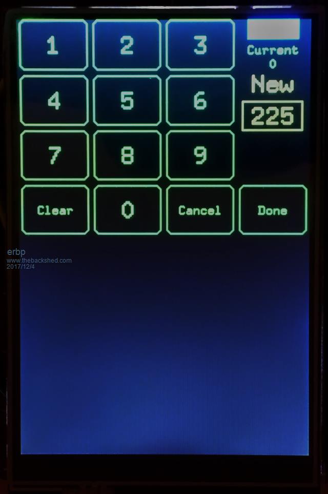

2. Use a "numeric keyboard" that will be displayed if you touch one of the color value buttons on the upper right of the main screen. This allows a value to be directly entered via the on-screen keyboard for the Color Component you selected. Repeat the process to set each of the other Color Component values as necessary.
The example below is for touching the 3rd (Blue) button.
This screen shows which Color Component has been selected, although the screenshot just shows a White box (upper right) it is actually Blue, the current Value for it and allows a new value to be entered via the keypad. Values 0 - 255 are valid, any value over 255 will display an error and the "Done" button will be disabled. When you have entered the value you want, touch the "Done" button to return to the main screen with the current value for the selected Color Component now displayed in the associated button. Note: The value displayed **may** not be exactly the value you entered via the keypad. It will be adjusted based on colordepth if necessary. This is explained later.
There are also "Clear" and "Cancel" buttons available on the keypad to allow re-entry of a value if a mistake was made, or to return to the main screen without changing the color value.

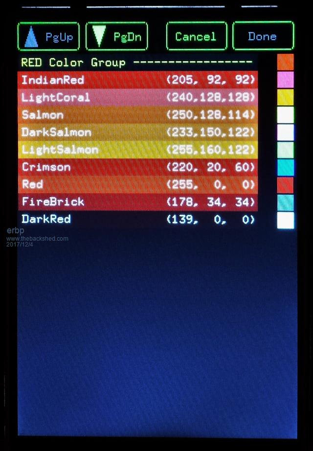

3. Select from the "Named Colors" list, displayed by touching the "Named Colors" button on the right above the Color Panel. The Named Colors list allows you to select one of the standard 140 HTML colors supposedly supported by all web browsers. The screen shown below will be displayed.
The 140 standard HTML colors are grouped into 10 Color Groups to make navigation easier - Red, Pink, Orange, Yellow, Purple, Green, Blue, Brown, Gray (incl Black) and White. When initially displayed, the list starts at the top - the Red group. You can use the PgUp / PgDn buttons (top left on the screen) to navigate up / down the list - the list displays 10 entries at a time and may include a Color Group header which can't be selected. The 10 color patches down the right side of the screen are shortcuts to the corresponding Color Groups in the list (although the colors in the screenshot are way off) - so if you are looking for a Blue color, instead of having to PgDn from Red to Blue, just touch the Blue color patch and the list will display from the start of the Blue Color Group.

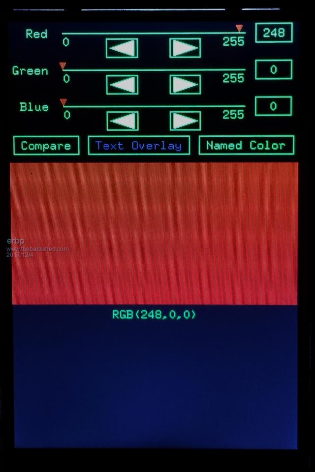

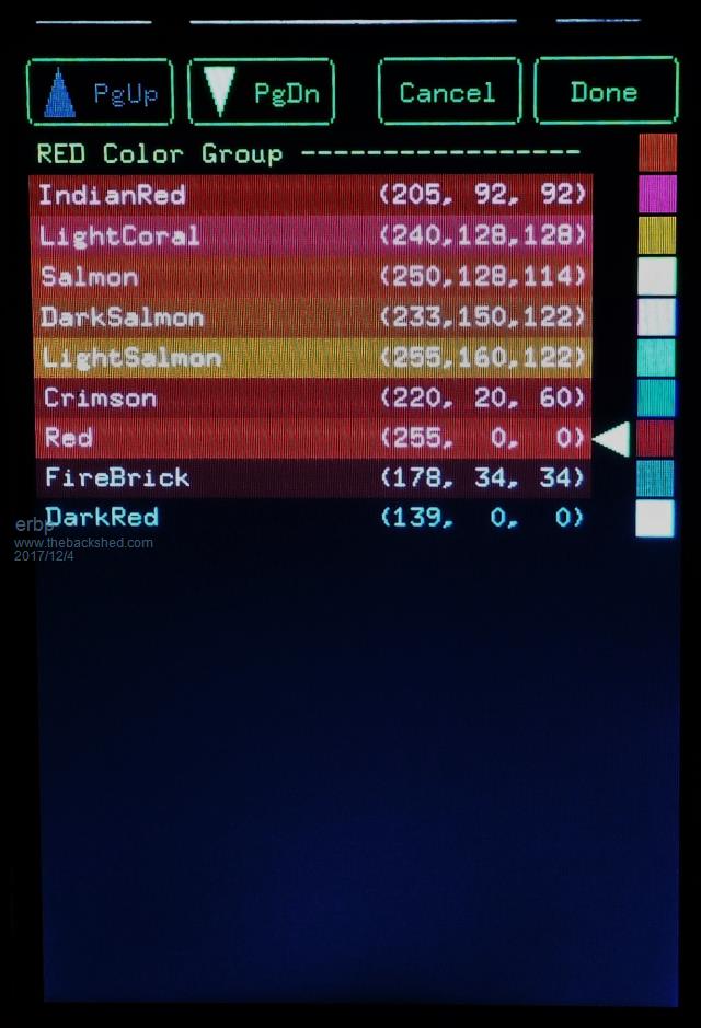

When you find the color you want, touch anywhere in that entry, the part of the screen showing that colored background. A "Selected" pointer will be displayed to the right of the entry touched, and the "Done" button will be enabled - touching it will return to the main screen with the selected color displayed and values displayed in the current Color Component value buttons. As in the previous section, the actual Color Component values **may** not be identical to those that were shown for the Named Color you selected (explained later).
If you select a color on the Named Colors screen but change your mind before touching the "Done" button, you can just touch another entry to select a different color. Also touching any of the PgUp, PgDn or Color Patch buttons will cancel the previous selection and disable the "Done" button until you make a new selection from the section of the list now displayed.
Note the value shown in the Red Color Component value is 248 not 255 as was the value shown for the Red color I selected on the Named Colors screen (see details about ColorDepth below).

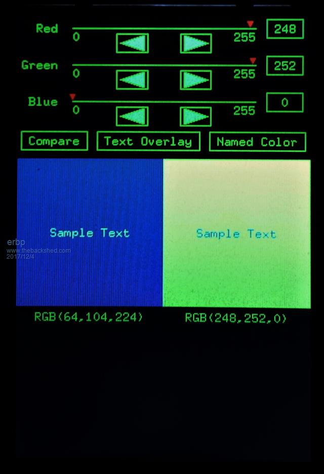

Compare Option.
If you want to see how one color looks beside a different one, select one of the colors first (as explained above), then with that color showing in the Color Panel on the main screen, touch the "Compare" button. The Color Panel will be split into 2 halves - left and right. The color you had selected will be shown on the left side, the right side will initially be Black. You can now use the controls to select the second color which will be displayed on the right side, thus allowing you to see how they look side by side.
While in "Compare" mode, all the controls ONLY affect the color on the right side, the original color on the left side is locked. If you want to change the original color, touch the "Compare" button to cancel Compare mode. The Color Panel will revert to showing only the original color and all controls now affect it only. After making the adjustment, touching the "Compare" button again will return to Compare mode with the split Color Panel - the right side will have remembered the color you last selected on it and that will be re-displayed. The controls will now only affect the right side again.
Text Overlay Option.
When "Compare" mode is enabled the "Text Overlay" button will also be anabled. Touching it will cause the string "Sample Text" to be displayed in the center of each Color Panel, using the font color of the opposite panel - thus you can judge how text in one color looks when displayed on a different color background - see example below.
