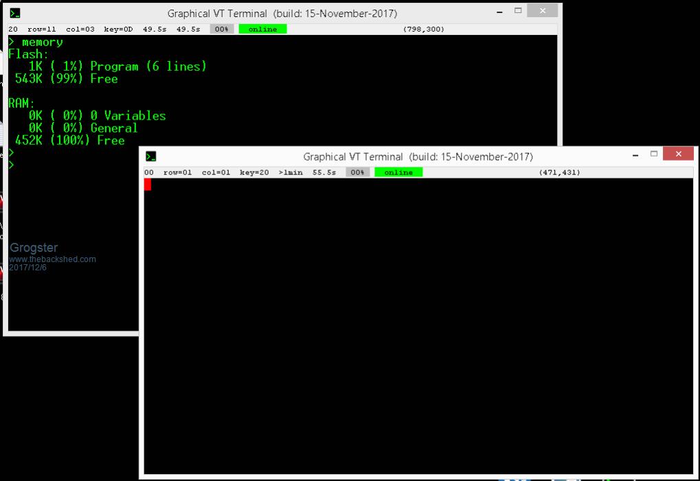

Would there be any problems using more than one microbridge on one system? Linux or Windows. Not for programming but for USB to Serial. Are all microbridges going to have the same serial number? I've had problems with some of the cheap USB to Serial converters over the years changing ports. I want to make sure my ports stay the same across reboots. My 16F1455 chips are on order but haven't shipped yet so I can't do any testing.
Thanks in advance, Max

EDIT: Plugged in two E28's and one MMX all with 1455 chips. All running at the same time, all of which were assigned unique COM ports, and I can talk to all of them. Here is a shot of my accessing two different 1455 projects at once:
